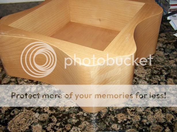

That came out pretty nice. I particularly like the joints in the corners. I’m not sure if the joint is really as thick as it looks or if it is an illusion due to the angle of the box, but it looks cool. Nice project.

It’s a nice box, and I like the design on the top. Is the inside of the box square??

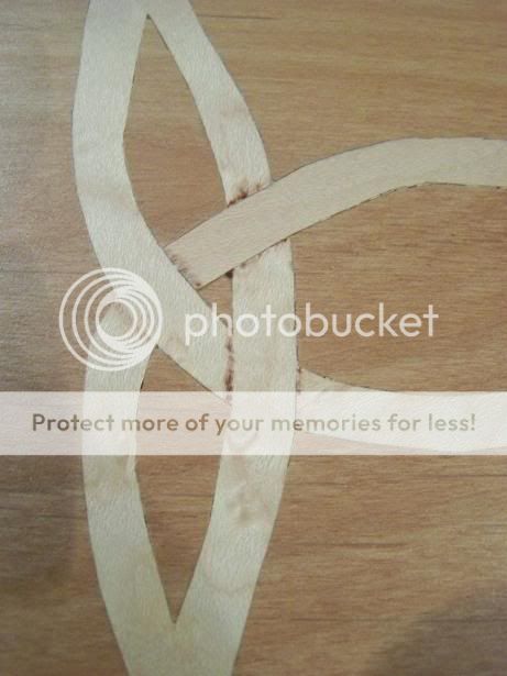

Bentlyj, the inside is square. I cut the shape after the box was assembled. Thanks for the comments guys. Here is a picture of the inlay up close so you can see in detail the burning. I slap myself for not doing it right but it’s fine. I think the inlay itself is pretty tight. I routed out a majority of the material and then chiseled to the line.
Here is a pic without the lid. I never saw the dust around the edges but my camara did. Crazy. I still need to do the hinges and felt. I am contenplating on making some wooden hinges, but I’m afraid that it will sit there for months unfinished. We’ll see. The corners are joined with box joints and because the material is so thick it makes them look long cut the way it is. That should help out those who are curious. Just simple joinery. The bottom is grooved in.

kolwdwrkr – I really like the shape of the box. I REALLY like what the shape of the box does to the box joints. I like the design on the inlay, but here is my only criticism will the inlay. I think that the inlay might look better, if you rotated it 45 degrees. That way the four legs on the inlay would point to the four corners of the box. Just my thoughts.
How do you plan on attaching the hinges? Have you thought about having a lid that lifts off with no hinges?

jimp, I was going to run the pattern into the corners believe me. I drew it a few times. The problem was the shape of the “eyes”. They have the sharp points and when put into the corners it looks like crap and I think I would have had to round things over. I think what happened was that I really liked the design I came up with and fit it to the top the way it looked best. I believe it was being lazy. I should have come up with a different design instead of being stingy with this one. I’ve also thought about the lid just being lifted off. That would really make me feel lazy, LOL. I think I need to make up for some of the short commings and come up with something cool. So I am really considering making the hinges. Thanks for the candor. Keep it coming. Every project is a learning experience.

I’m going to disagree with jimp I think inlay pattern is placed perfectly and would look very crowed if it was turned those 45 degrees. Besides you’ve obviously mastered the craft and for now a one of a kind (bet it won’t be for long. great craftsmanship and really great design.

you could make the line transitions more fluid by getting a set of “french curves”. ....inexpensive plastic plates that have every eliptical shape on the planet. I cant do without them!
