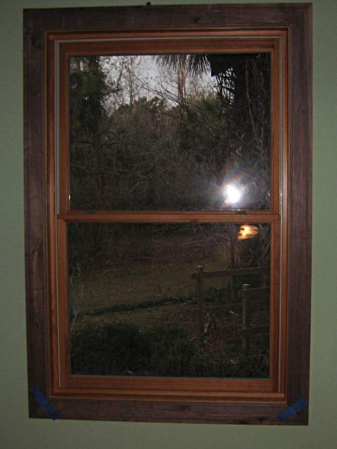

New Black Walnut window trim being dry fit on window. Raw walnut without any finish; straight off the tools—pre-final scraping and finishing.

The window trim has been harder than I’d imagined. I’ve run into many difficult issues.
The ogee profile along the window has a backcut rebate leaving a 3/8” reveal around the window jambs.
The extension jambs are longer than they need to be and they protrude unevenly beyond the drywall.
The 4/4 walnut wasn’t thick enough to mill the profile and create the reveal. And, Judy was adamant that I not try to cut the extension jambs back to the drywall. Her instincts were good, as trying to do that would’ve created other problems.
Here’s the challenge I ran into:
The windows are square but not plumb and true to the drywall anymore due to minor settling.
To use the milled 4/4 walnut with the ogee profile AND create a reveal, one option would’ve been to angle the walnut back to the wall creating the need for a compound miter to make the corners meet tightly. The angle changes as the distance from the extension jamb to the drywall varies, so each corner would’ve required a trial and error fit. As far as I’m concerned, that opens the door for mistakes and the opportunity to overcut something on the last tweak, causing the need to remake trim. I opted against that.
So long as I keep the new trim in a single plane, the miters could all be cut at 45 degrees and be tight.
However, this means I have to rip and plane walnut to build up the gap between the drywall and the new trim. Hence, the need to dry fit the trim as pictured so I can create a story stick for each side of the window.
I’ll be ripping and planing walnut that’ll be glue to the back of the new trim at the outer edge so there’s no gaps between the walnut and drywall.
