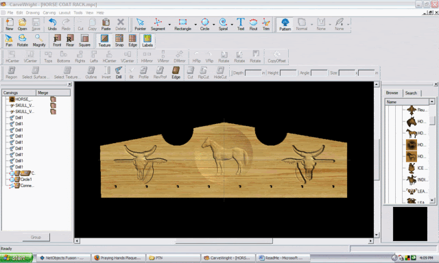

I saw a Coat Rack in the Projects section and decided to try it on the CarveWright. Below is a picture of what it would come out of the machine looking like. Keep in mind that it will actually cut out the piece from the board. In this case the board’s dimensions are 12”x36”x.750” The little circles along the bottom edge are actually the holes for the Shaker Pegs. I had the machine pre-drill them at .250” x .250” deep.
