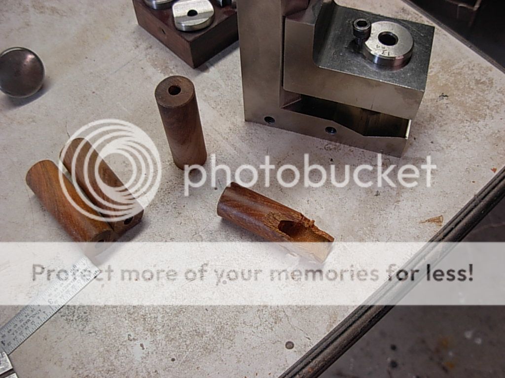

This stand is made with ash, corian and brass. The top and the shelf are floating – shown in the second shot and the corian shelves have brass inserts shown in the 5th shot with the standoff rings.All put together with Harbor Freight epoxy!! The lower shelf is supported by 5/8” brass tubes that are screwed into the legs and then have screws into the bottom of the corian. I had made 4 ironwood tubes, but the first one shattered when I tried to drill that hole through the side so I ordered some brass and I knew that would be okay.
The horizontal holes in those curved legs were a tough job to try to do with a Forstner bit. They danced off center and I finally wound up doing them in the mill with a 5/8” router bit and everything clamped in the vise.

Here is a shot of the broken Iron Wood tubes I made the first time:
