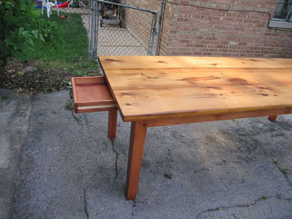

Here is another project that I have built for my father in law. It’s an 8’ long harvest table that has an 1 3/4 top built from old floorboards from a 200 year old cattle barn. The legs, skirt, and drawers are built from reclaimed pine as well, but weren’t nearly as old, so I had to tint the finishe to attempt to make them match the patina of the top. I know purists be damned, but I did plane the surface just a bit to smooth out the hoof marks. This table sees much use in a cabin in Northern Wisconsin, and needed to be easy to clean. I did leave the bottom untouched, so that one day, if desired, the top could be flipped over, and the real patina and wear could be displayed.
The legs have ebony plugs that are pegged through the tennons on the skirts, ensuring a lifetime(or two) of use.

very good looking table, do you have a pic of the top? from what I can see the grain is stunning.

Here’s the only picture I have showing the top.

you have done a very fine job and the top is great. looks like it will last many generations.
