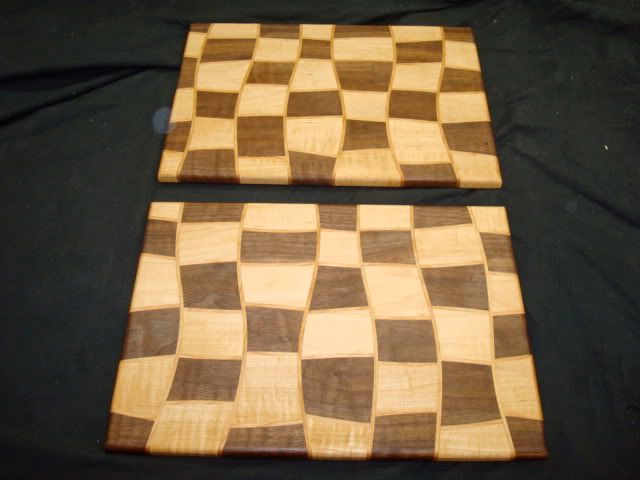

Hey everybody, after a few personal messages here is my version of a how to on a Drunken Checker Board. I of coarse bow to the Chairman of the Board and pay tribute with beer. This is a Off-Checker pattern I call “Drunken Alice in Wonderland” The “serendipitous” nature of this piece is appealing in a far out sort of way. Here Goes…

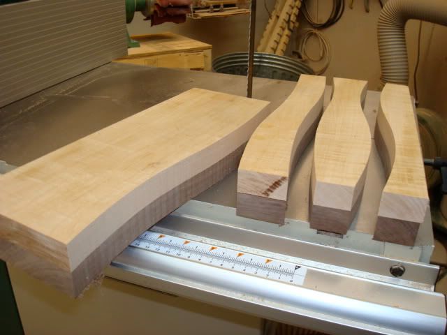

Then Double sided tape one Walnut and one Hard Maple blank together, flat and square, to run through bandsaw.
I make 5 length-wise rips with a S shape and a Opposing S shape making what I call a vase shape. Your Imagination is your only limit here and the fact that you have to clamp it back together.
I then lightly sand the cuts smooth trying not to change the shape of the cut at all.
In a orderly fashion pull pieces apart and alternating pieces lay out two matching boards.

is it something like this ?
View poroskywood's profile
poroskywood
198 posts in 264 days
posted 81 days ago
Ok David, I think you got it. OMFG! I now have a beer for David our CEO.

This is pure genius or complete insanity! Great, Inspiring Idea! I see it now. I was thinking when I was making these, you could make a table or panels out of these because the boards match up you could join a bunch together for a lid to a box or a door for that matter. I feel like we are drinking beers in the woodshop together.

Both Curly Maple AND Curly Walnut !!! You’re my hero , Scottie : ) Thanks for simplifying this process for the weak at heart like myself : ) Your blog and photos are excellent and I am looking forward to your next post on this subject. What size blade are you using and do you draw lines to follow , or just freehand your curves ?
That’s a nice sanding drum that you have there . What’s the model # ?

Len, 1/2” Timberwolf. would do this fine. For this blog I left on my 1” 3tpi resaw blade. (lazy) I cut the curves free hand with out lines in a semi specific way due to the lack of any nessasary pattern. All I have is Curly wood I can’t help it. It’s the Grizzly drum and flap sander I think its a 4” drum, VERY handy for the cost.

Does it say anything about my sobriety if that board looks straight to me?
