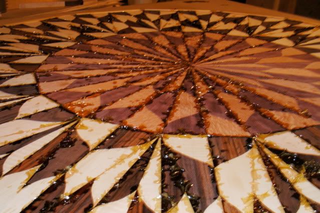

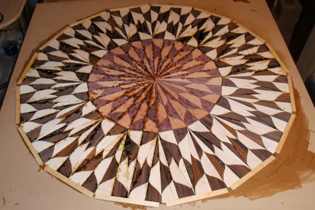

heres the results , the epoxy is above the surface of the inlay ,
it cane up through the joints .
this tells me that the inlay is down flat and even .and not all hill and dale lumpy ,
so sanding will be even .

because of the backstops ,
the last quarter is also trapped .
i will rout the top to round to the point tips ,
the but ends don’t matter ,
as there is plenty there ,
and leave a tongue from the top as a fin for the border dadoes to fit to.
just use slow glue , as it takes some finessing ,
and you want a fine notched spreader ,
so the glue doesn’t ” float ” the pieces .

im sanding right now , that epoxy is HARD man !
might be easier to do what i did with the first one ,
i had apiece of ply big enough to cover the whole thing ,
and then the vacuumit , the glue didn’t seep through ,
so i didn’t have to sand so much ,
but it was pine and alder so was easy to do .
this is HARD wood , so it’s bound to be harder ,
if i had time and money ,
i would take it to a 52” wide belt sander and let them do it ,
then just finish it .
