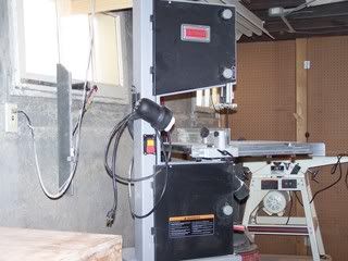

I have the craftsman 22400 12” Bandsaw, I bought it for $ 289.00.
Like you money was the issue (still is). Like the band saw you have now the craftsman
has an odd size blade 89 1/2 ”, but it has been a really good worker for me.
[IMG]http://i842.photobucket.com/albums/zz345/rkollman/138.jpg[/IMG]
I cut mostly shapes and profiles with it, I do not do much resawing, most I’ve ever tried was 5.5”
it does have a 7” resaw capacity. I have had no problems re sawing, but I go slow and being a
one horse or horse and a half saw, I know it’s limitations. I use this saw a lot and it has not been a
problem. I had to repair the swithch on it, but that’s all the problems it has given me in 4 years.
Happy saw hunting, in whatever you choose!!!!
