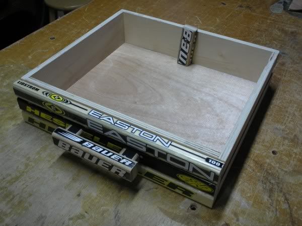

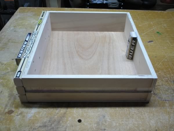

Built a drawer to fit the opening in the table. Nothing fancy, just some plywood left over from some other project. Since I was using hockey sticks for the front, I made it shorter by their thickness so when the drawer is closed it fits flush with the table opening. I added a handle to allow easy opening and a rotational hockey stick piece in the back to prevent the drawer from falling out if pulled all the way. Just rotate the stick to install and it rotates vertical for interfearance on the table unless rotated again for removal. Simple but effective. I also went with grooves for drawer slides made from hardwood. Trimmed for a slight slip fit, they hold the drawer level when slid open and it works great.
