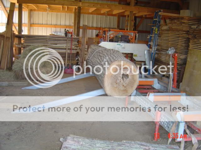

I have used something like this to load some real big logs on my manual mill. It has worked real well and has never even remotely affected the sawmill. It works good but somedays I dream of hydraulics and a bright new orange woodmizer with all the bells and whistles. Oh well it never hurts to dream.
Loading a log the old fashioned way.

You can use almost anything for a power source. A hand winch like swiowasawyer uses will work great or you can use a pickup or car if you have the room (go slow).
Keith,
I think it would work fine on a small mill as long as the mill is stable; check out swiowasawyer’s set up. Looks pretty solid.
