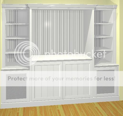

View kolwdwrkr's profile
kolwdwrkr
2821 posts in 3557 days
#4 posted 01-26-2010 08:19 AM
Hey Bently. Here is the drawing in KCDW. Sorry, I’m not a sketchup user. The learning curve is out of my league. LOL

View Kristoffer's profile
Kristoffer
675 posts in 3182 days
#6 posted 01-26-2010 05:29 PM
I thought that you were going to route a detail in the shelf edging? I don’t see that in the drawing. I think that you should start over from the beginning. Just kidding, it’s looking great. That’s a good days work. I find it hard to have that kind of motivation on low budget jobs, which is why I don’t take ‘em anymore.
