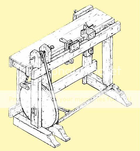

you mean like this? I had the same idea. Looking forward to this series.
