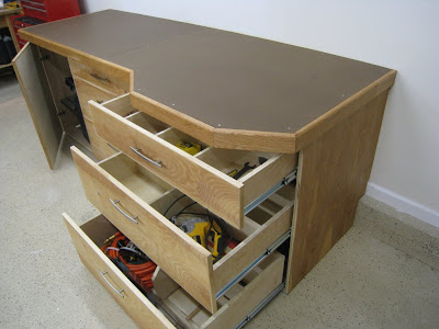

posted 162 days ago
Well, mine is not a true miter bench, but here it is. I plan on adding an infeed support that acts storage when it’s pushed to the back of the bench as well. In my case the right side will be a router table that doubles as support for the miter. It’s plywood and 2×4’s, but it could be MDF.
