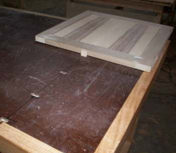

I used the Domino (once I found it....more on that later as well...stay tuned for another blog series) to align the apron to the table top. It all fit. I was happy because I didn't do a dry fit to find out. I either have that much faith in the Domino, or in my vast skills. D'OH. I just didn't want to put that dovetail joint together again as they fit the best the FIRST time, not the 4th.
The camera with shadow and flash pics up some tear out that I can't appreciate with my eye, but here it is glued up, clamped, and awaiting the vise.
