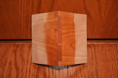

I’m by no means an expert but I’ve gotten acceptable results after a couple hours of practice. I’m using Rob Cosman’s technique. I highly recommend the DVD’s. Having a properly set up dovetail saw is critical. Most saws are not set up properly. Make lots of “5-minute” dovetails (one tail and two pins) which requires a minimum of chopping to practice.
And a real project after another hour of “warm-up”...Desk 001

Che – your first attempt looks pretty good to me! I’ll get some pictures of mine posted soon…
I’ll need to get one of those DVD’s. I have a Woodcraft store close by and they rent them there.
