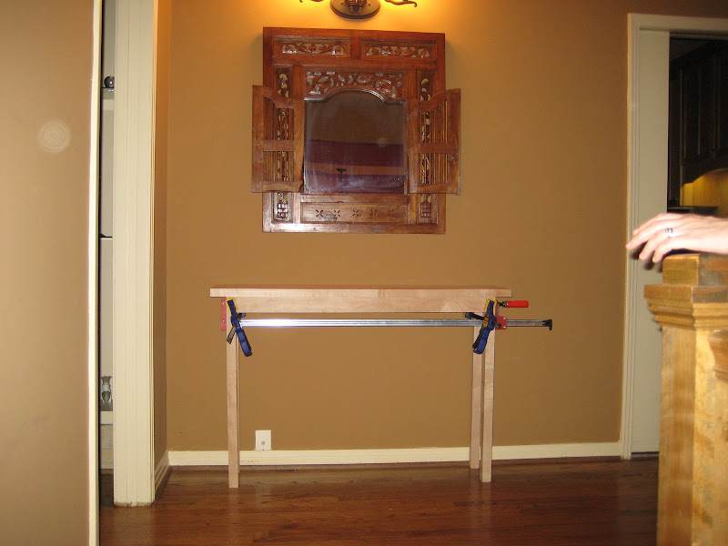

By the end of the day I had something that actually looked like a table. Finally, some progress that is visible to the rest of the world. I clamped the table up and let Mrs. Doug have a look at it. She suggested that we take it up and put it in position for analysis. I will have to upload a picture later. It fit where it was suposed to. Proportions look good. As an added bonus it looks like I got off the hook on tapering the legs. The outside border on the picture window is the same thickness as the legs on the table. Since the picture window is all square geometry it makes sense to leave the table legs straight. That’s good because I don’t have a jig or guide to taper legs.

Table looks good, kinda light! Tapering squate legs is really simple, it’s not too late if you decide to. The jig is easy to make from a couple of pieces of scrap and an old hinge. If you taper the legs you might consider beveling the underside of the top. It’s a nice touch that makes the top “float”. Looks like maple, can be difficult to finish. Good project….well done! Thanks for sharing.

Don, some good suggestions all around. Yes, it is light (not weight wise, but color it is Maple). I have already found a stain and finish that matches the picture window very nicely. I considered adding a bevel to the table top or beading the edge. I think both would look great, but would take the table away from matching the relatively simple straight lines of the picture window. I am open to suggestion/discussion. It is kind of hard in this instance, matching with the picture window, because there are a lot of nice touches like bevels, beading, and rounding that could dress up this little table.
If I were to taper the legs at this point I would likely just mark out the taper, bandsaw it, than clean them up with plane and scraper. They wouldn’t be perfectly matched, but it would take little if any fixturing time.

Doing tapered legs…..make a fixture you will save lots more time sanding after the bandsaw than it takes to make the jig.
You can find jig instructions on the web.
