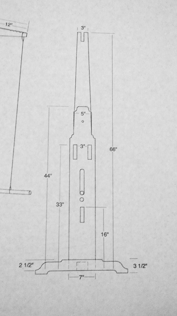

I can’t begin to tell you of the enjoyment that I receive when ever I travel down the road with you. You are a great storyteller, a wonderful spirit, and a fine craftsman. Please continue to include us in your journeys, they are a fantastic way to break the stress of the day.. That’s quite the maul that you have created.. can you post some pics of your lathe? I would love to create one for myself. thanks again Joe.. My heart beats anew for the next journey.. Papa

Hey Papa,.....hope this works….lol. Here are 2 shots from the plans of this lathe in Roy’s book. Hope this is an aid for you or anyone interested in this setup. This is a wonderful book filled with tons of great stories, tools and trades, I hope you may purchase it. You may find this link helpful for that. It includes plans for another lathe as well! The entire book is illustrated by his daughter and has incredible artwork!
http://www.amazon.com/The-Woodwrights-Guide-Working-Wedge/dp/0807859141/ref=sr_1_1?ie=UTF8&qid=1344618233&sr=8-1&keywords=roy+underhill+wedge
Here are the pics:
