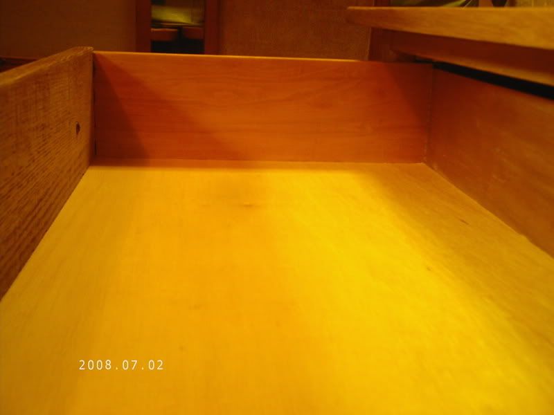

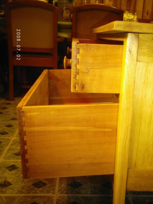

I dont know what was in it before, but what had been put in was pretty lousy. I hated to do it , but I had to replace the bottom with 1/4’’ ply. Other than the bottoms its all solid wood. I sanded the drawer sides down today and discovered they were cherry. I almost fell over. After I got all the drawers fixed and put back together I gave it another coat of wipe on poly. The entire piece has 3 coats of poly. Between coats I used 0000 steel wool. I didn’t want to completely cover up the grain. I like to be able to feel the texture and yet have a finished look. This is just my personal preference. While working on the drawers and reassembly of the cabinet, I gave the top a total of 4 coats of the poly treatment. I figured I better since I have this thing of not being able to pour coffee and get it all in the cup. ;-)

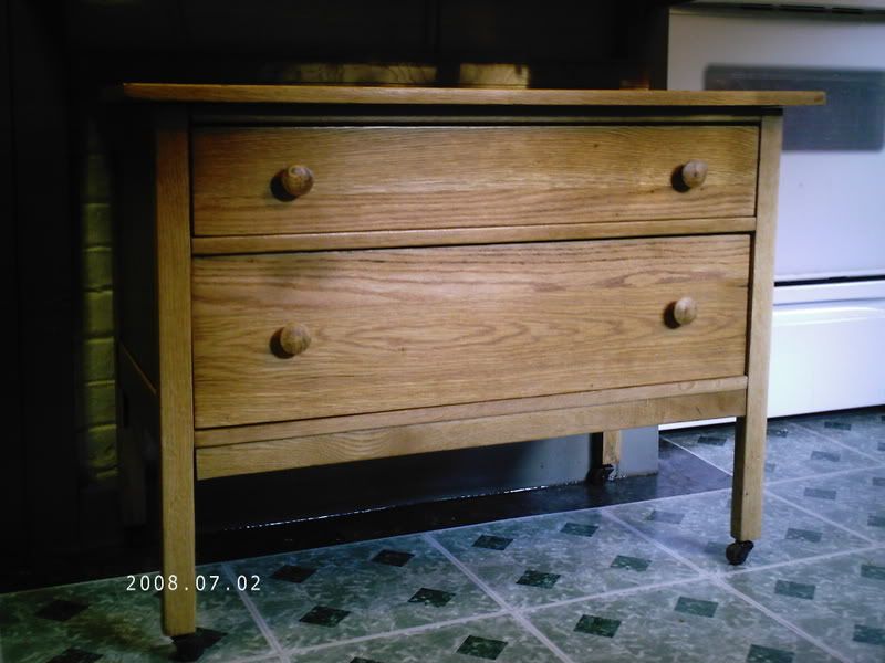

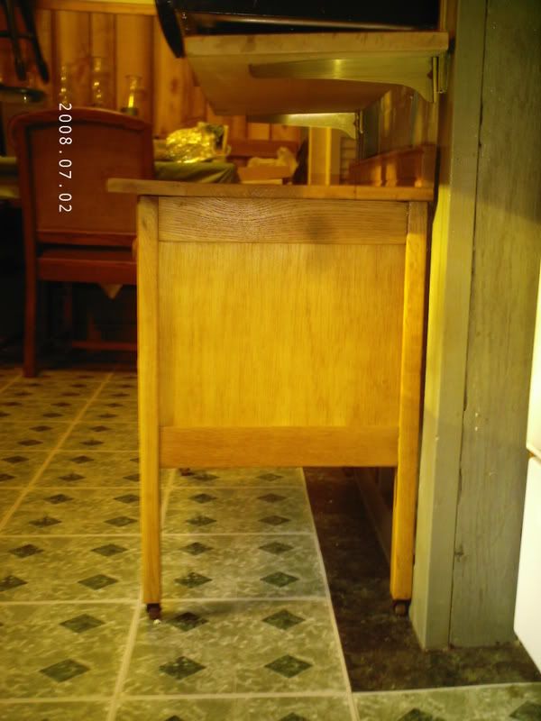

Ok now for something different. IT’S DONE!
The pictures don’t do it justice. Saying that….here we go.
I had to add my own personal touch to the top. Someone over the years had nailed down the back of the top and left holes and reminders of missing the nails a few times with the hammer. It is Oak as well.
The pictures don’t do justice to the Cherry drawer sides. There is a lot of luster there that the camera wont pick up.
I think it all turned out fairly well for my first attempt at restoration. Its not perfect by any means, but its good enough for who its for. LOL Thanks for all the comments folks. Now for the next project. Hmmmm, wonder what the LOML will think of next?
