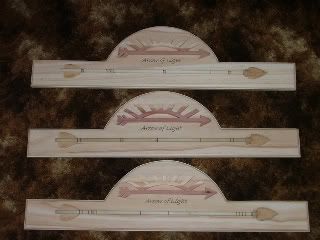

These are the ones I made – they do not have any finish on them yet. I may need to borrow your jig.
arrow of light
