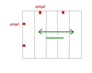

Okay Jim, now how can I explain those clips, I will try will a few simple sketches…
There are clips on the edges of the wood (zclip1) and clips on the ends (zclip2):
zclips

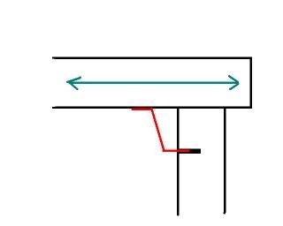

If the top moves in the direction of the arrows (the width of the top) then the clips (shown as zclip1) will be more into the kerf in the case of the wood shrinking and the clips will be less in the kerf in the case of the wood expanding:

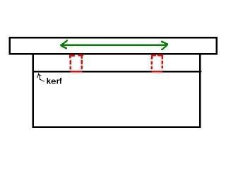

If the top moves in the direction of the arrows (still the width of the top) then these clips will move along sideways in the kerf:
zclip2
I hope this explains the clips.

Thanks a lot Julie. That helps me understand the theory for the zclip1. I can easily understand the zclip2 thing. One more question about the clamps if you don’t mind. The aprons you used are 3/8” thick. Lets say you decided to make the kerf 3/16” deep because I can’t see going more than half way through. When you installed the clips on the edges, zclip1, did you place them half way into the kerf? That would mean you placed them 3/32” into the kerf, right? Or, did you assume the wood would only shrink and place them all the way into the kerf? Or, how did you decide what to do and how did you do it? Is that more than one question? lol Sorry. Anything you can offer would be appreciated.
Best,
-- Jim

Jim, the aprons are 3/4” thick not 3/8”. I don’t believe 3/8” would allow enough space for the clips.
Here’s the picture from Lee Valley, which I hope is okay to link to here:
Lee Valley tabletop clamps
In my climate there is quite a range of humidity. In the winter here it’s dry and so if I’m making something in the winter, I need to assume that the wood will expand. Of course the opposite applies in the summer. So this will determine, just the same as if you are making floating door panels, for example, how “deep” you apply the clips.
Perhaps others don’t have such a variation as we do here, and don’t have to plan for that, but if you are shipping something across the country you will need to take changing climates into account.
-- ~Julie~ followyourheartwoodworking.blogspot.ca

OutPutter
1199 posts in 3954 days
#11 posted 02-15-2010 11:04 AM
Thanks again Julie. How deep was your kerf and how deep did you install the clips then?

#12 posted 02-16-2010 03:39 PM
Hi Jim
I honestly don’t remember, but most likely the kerf was approximately half the wood thickness, so that would be 3/8” and since I made it in the fall, I probably stuck the clip in most of the way, say, just over 2/8”.
Really, I much prefer the home made buttons (which I usually use) and they work on the same principle. Being hardwood, they look much nicer than a piece of metal under the table.
