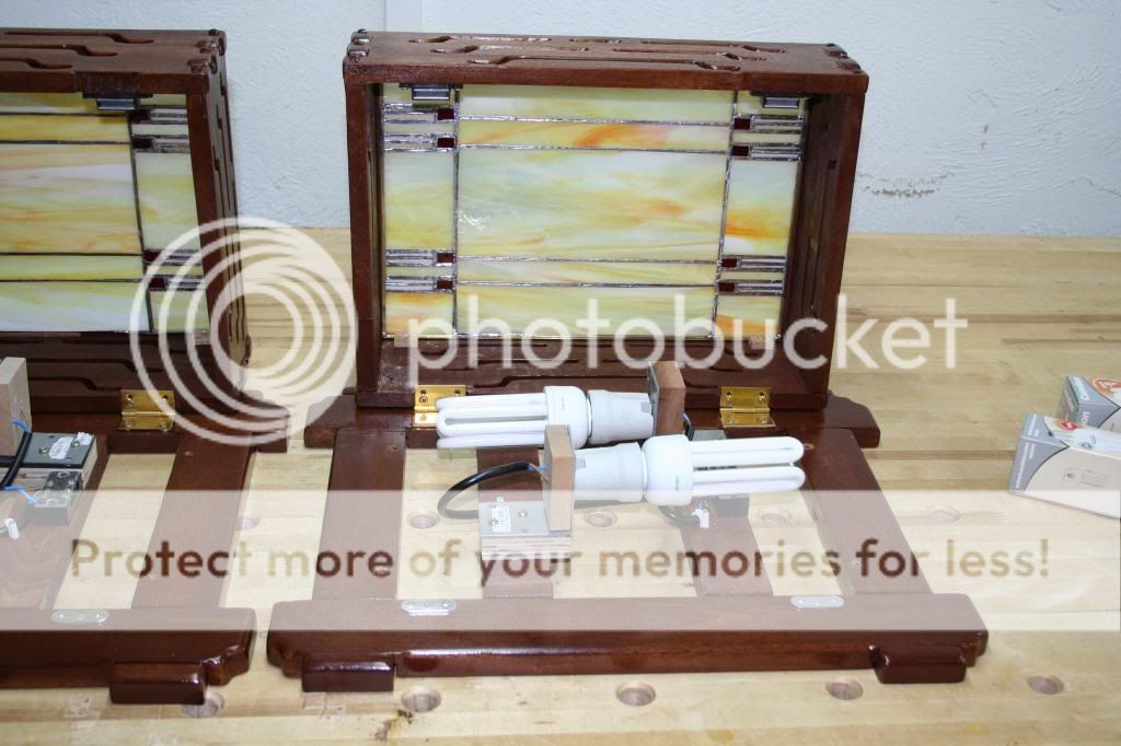

In this blog I’ll show to you the process of making Greene and Greene ceiling lamp. 1. To cut workpieces
 photo IMG_1217_zpse7ebf215.jpg 2.Joint with biscuits
 photo IMG_1220_zps15fa18ee.jpg 3. Glue workpieces
4.Makiing patterns
 photo IMG_1218_zpscc62f859.jpg  photo IMG_1323_zpsc675dd57.jpg 5. Routing workpieces with patterns
 photo IMG_1324_zps3e816b64.jpg 6. Making mortises for the hinges
 photo IMG_1228_zpsbf02928b.jpg 7.Routing bases components
 photo IMG_1225_zps5308b095.jpg 8.Gluing base
 photo IMG_1234_zps2ecfe046.jpg 9.This is device for the routing joints of the covers component
 photo IMG_1492_zps778423e7.jpg 10. Assembly
 photo IMG_1495_zpsb7519b9e.jpg 11. Staine and finish
 photo IMG_1604_zps77f8afbd.jpg 12. Assembly lamp with stain glass and fixtures

How do you make the pegs? How is the stained glass held in place? The jig for routing the joints is very clever and simple!! Thank you for sharing all this.

Sorry for my English, what the pegs? The stained glass held in place with four wooden small stop blocks in the all corners of the cover. Tis picture is better

edward60, what are the dimensions of the light. I was trying to guess by looking at it, just curious. Thank you

Dimensions of the base 18”х 13”х 3/4”, light box 15”х 12”х 5”.
