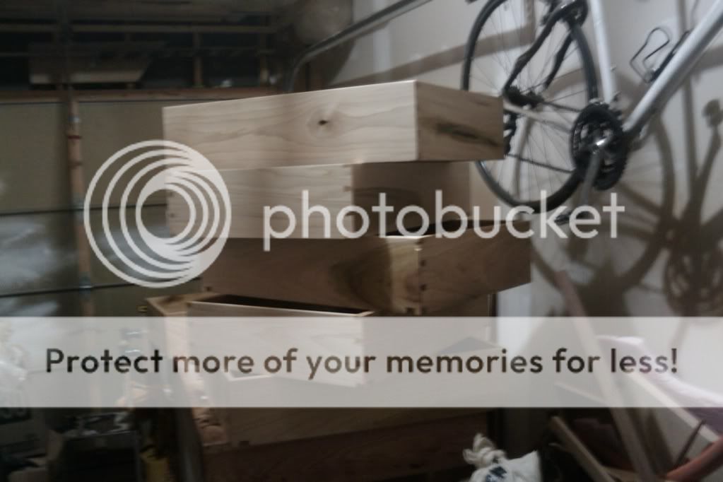

starting to look a bit decent with some stain on it. Just updating my progress…I’m a bit anxious to finish this one

That’s looking really good! Can’t wait to see the finished product!
Is that a traditional mahogany stain color? Maybe shoot it outside in the early morning sun when it’s done to get the real color?

Love the color!!

Just got caught up with your progress. very nice project indeed. What type of stain are you using? The color looks real nice.

Thanks guys….Ron I used minwax Brazilian gel stain just to get some uniformity to the project. I also used watco’s danish oil /walnut stain to brown it a little b’cuz it was to red for me. I’m glad that you like the color thou
gh. The oil is taking forever to dry

This is looking pretty good. I can empathize with you about wanting to get the dresser completed. At this stage in a project I really start getting anxious to see the “finished” piece.
A long drying time is one of the challenges with Watco’s danish oil. It contains raw linseed oil, rather than boiled linseed oil, which takes quite a while to cure. Just be patient. :)

i must say out of everything that i’ve done finishing is the most difficult because it takes up so much time and effort to achieve the look you’re after. these drawers for instance are just finished polyed to get that highend look
