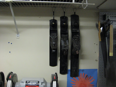

Well, I have a nice drawer system in my garage. Problem is that a No6 is the biggest plane that effectively fits in the drawers. I have been tinkering with ideas for cabinets, wall boards, etc…

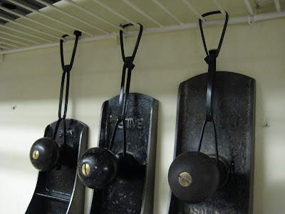

Well, today I had a silly notion to just string them up by their knobs and be done with it. A few nylon zip ties later and I can happily say that it works great and was very easy to install.
-- Doug, woodworking in Alabama

Check out Thos Angle and i think Douglas Border on their tool racks.
Great job.

Tool rack will have to wait for a time when I don’t have other pressing projects. For now this gets the planes off of where they have been stacked and a bit safer. The zip ties allow them to slip on and off the shelf they hang from with little fear of accidental slips and drops.

If I’d thought of this I probably wouldn’t have built a plane rack. Great idea.

that is a good idea, i believe i’ll use it too. i’m in the process of turning a very small one car garage into a working woodshop. it’s quite a challenge but it is slowly getting there. thanks for the good idea for my planes.

I have a few planes where someone has drilled a hole in the bed and simply hung them on a nail…
I imagine if they had seen the brilliant simplicity of your idea, they’d kick themselves in the rear for drilling the hole.
Great idea.

good way of hanging and displaying

Nice job!

Hey guys, thanks for the comments. One item I didn’t mention earlier that is somewhat important. The three loops aren’t there just because I had extra zip ties. Basically the loop that the knob hangs from should be snug and just slip over the knob. By having a snug fit it insures that the plane won’t accidentally liberate itself if you happen to bump it. Just FYI for anyone who is rushing out to the shop with a handful of zipties :-)
