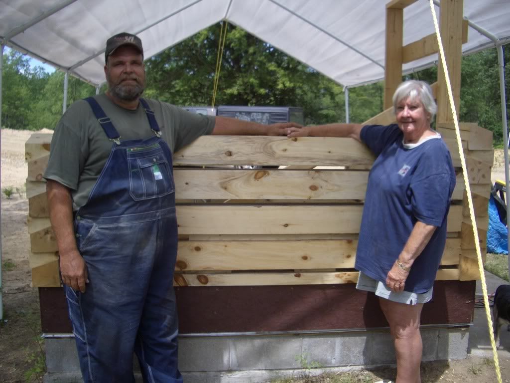

We have started.We are building the pump house first to learn from our mistakes, so far its going good just making some adjustments to the chain saw cutting the dove tails.It looks great but it takes a long time with drilling all the holes you need for electric and the thru bolts you need on all corners and cutting the dove tails.Here is a picture so far what we have done..I hope I can get a picture on…..If this loads this is a picture of the pump house what we have done so far and my mom she was visiting from New York.....

Hi Bob, why have you decided on using dovetails?

I like how it ties everything together and when you look at it..its like art…..For me atleast..

Much better, thanks. Ah, I see now. Ok, so this a ‘chinked’ log cabin.
Ok, well I’m a fan of the notched and scribed log building myself. Tighter weather tight joints, forced log cracking relief to be inside the joint, no chinking required, no bolts required and wood shrinkage factor is ‘built in’. More work however.
I suppose though, this is the log cabin style of the area as I believe it was on the other side of the border too in Ontario.
Looking good so far – keep us posted!

Here ya go – the original picture – you’ll just have to shrink it a bit for next time – poor old Mom gets left out!

Looks good. Are you using a jig to keep the chainsaw consistent or just cutting it by hand to a line?

I made a jig to keep the chainsaw consistent.
