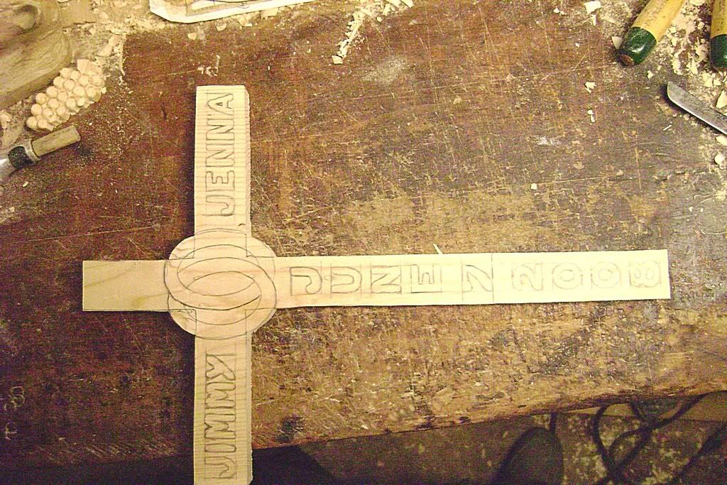

Here is the layout in pencil

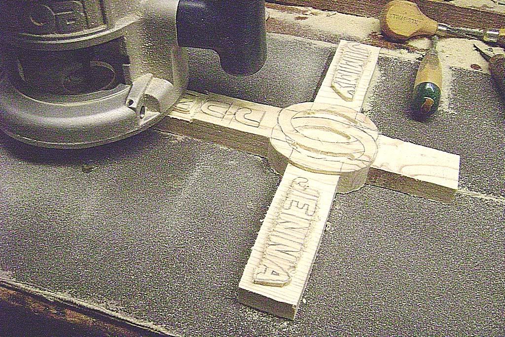

Here I have the top routed about 1/8” deep with a 1/4” bit. I usually start from the outside edges and route towards the center of the cross.

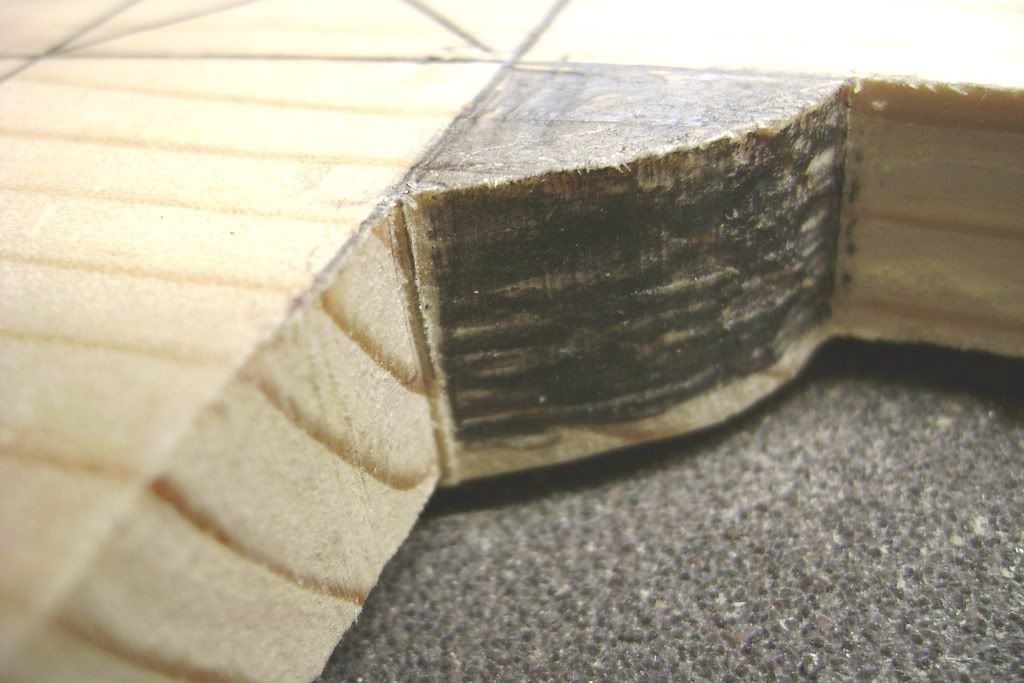

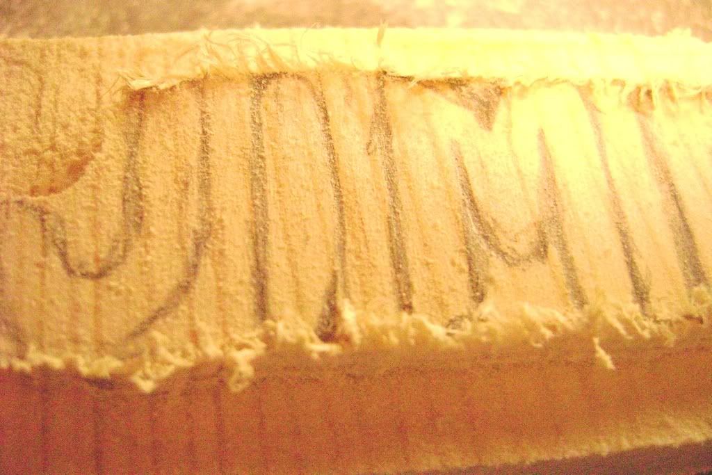

After routing pine the project has the fuzzies all over where routed. My next step is to remove these furry edges so the router can cut the proper depth with the 1/8” bit.
The next 2 photos show the fuzzies.

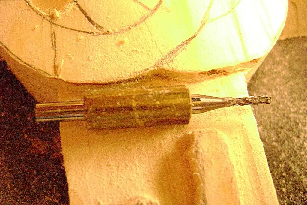

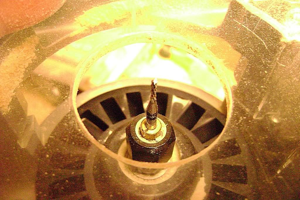

This picture shows the 1/4” to 1/8” adapter I made to hold my 1/8” bit in my 1/4” router chuck. I use to do this part with a Dremel tool routing attachment, but I couldn’t keep one from blowing up … I use to keep 3 of them on hand, just for that purpose. I used a piece of thick wall brass tubing that just fit both the router and the bit. Then cut a slot the length of the brass tubing…. the tightening of the router locking nut puts pressure enough on the brass tube to hold the bit firm. The next picture just shows the assembly mounted in the router.

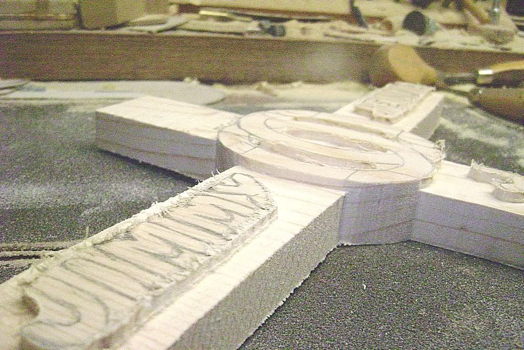

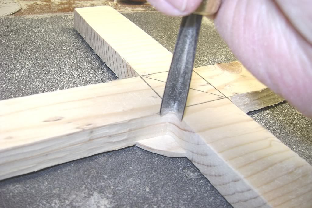

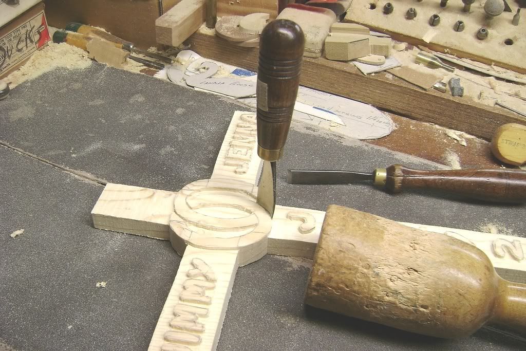

This next step with photo #7 shows me stop cutting the rings, then rounding the rings with the same gouge tool(I use 2 or 3 different size gouges), but leaving the tool marks which show the hand work being done. Each corner within the rings are more deeply relieved to show more seperation from each other. They must look like they overlap each other.

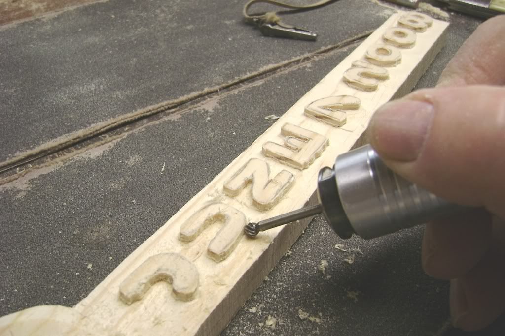

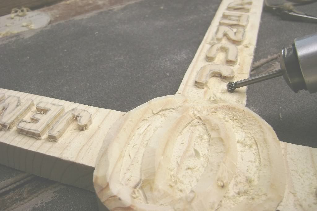

Step 8 and 9 shows me doing the background of the lettering with a small round grinder in my flexible shaft Foredom. The round bit keeps the gouge handcarved look. As I get older and weaker, I must devise easier ways of doing some things. I also need to make a profit…. but I still do some larger (and smaller) projects entirely by hand. That’s the real fun part!

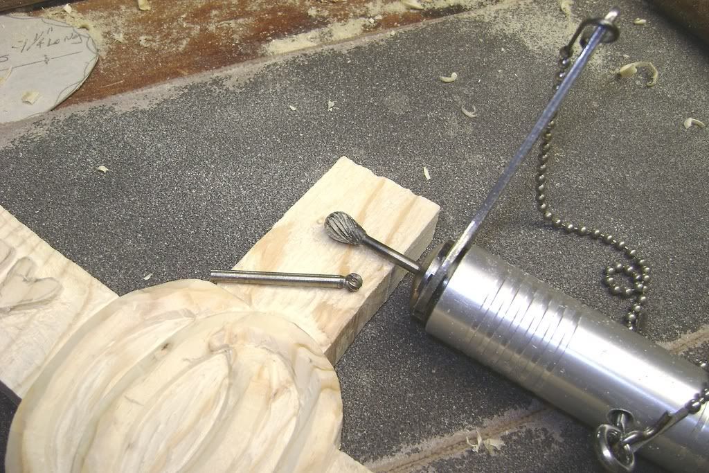

This pic simply shows the type of bits used for this operation. I go over the whole background area removing the marks made by the router bit…. (giving the cross more of a handcarved effect, which it really is)

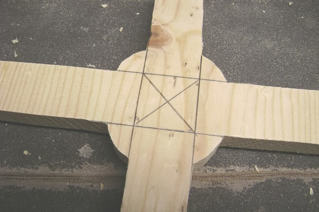

The next step I mark the center of the back by extending the cross sections all the way through, then tracing diagonal lines through the square and I have the exact center for a keyhole for hanging…. (so it will not hang whap-sided).

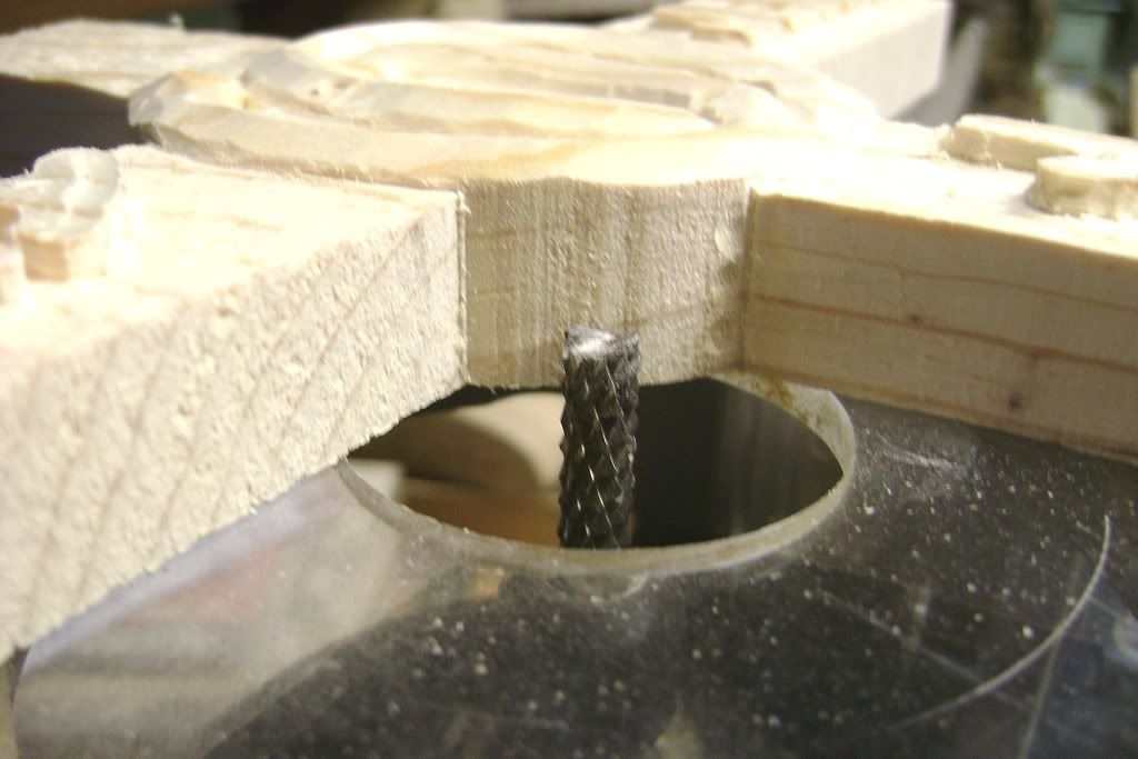

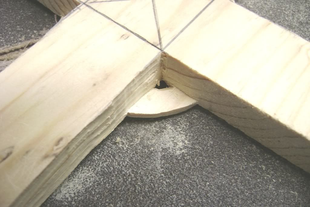

Here, I show the next part I will be routing, and the depth….from the back side… (the dark penciled in area), I leave about 1/8th inch for the rings to stay attached to the cross beams.

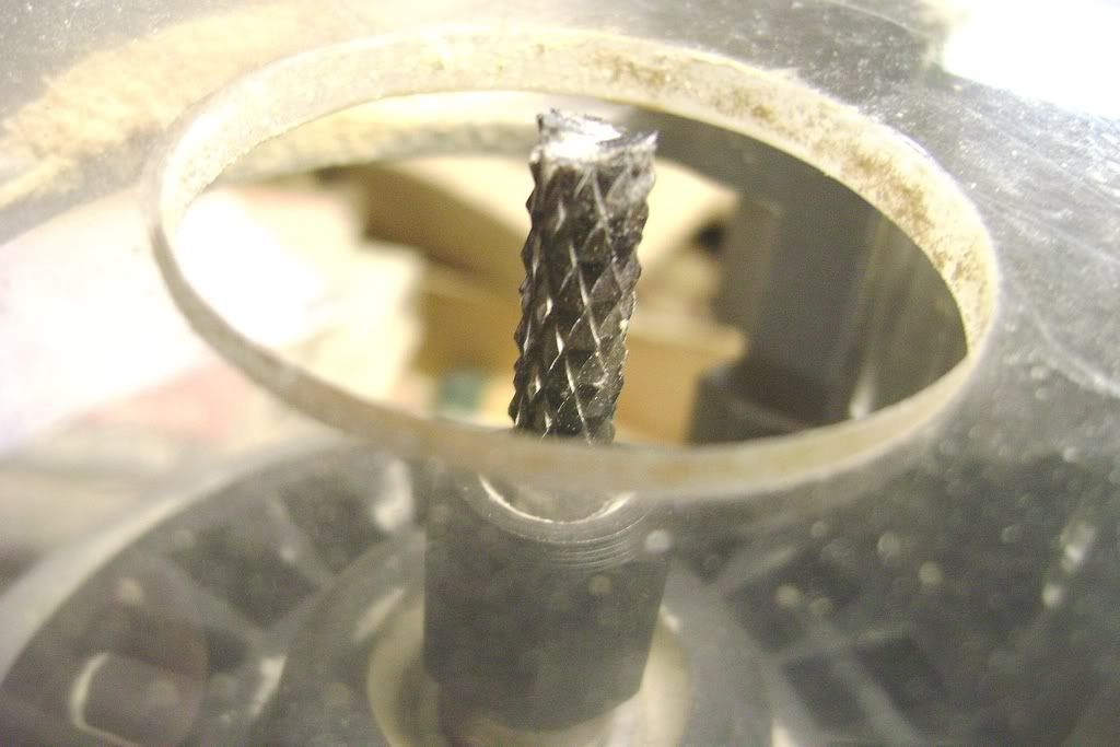

This pic shows my unique 1/4” bit (the best you will ever encounter)

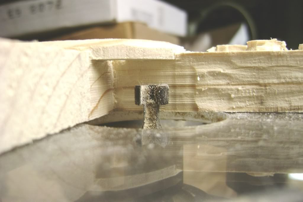

This one shows the depth of my first cut… about 3/8” deep. .....I do this operation in 2 cuts to get to the rings.

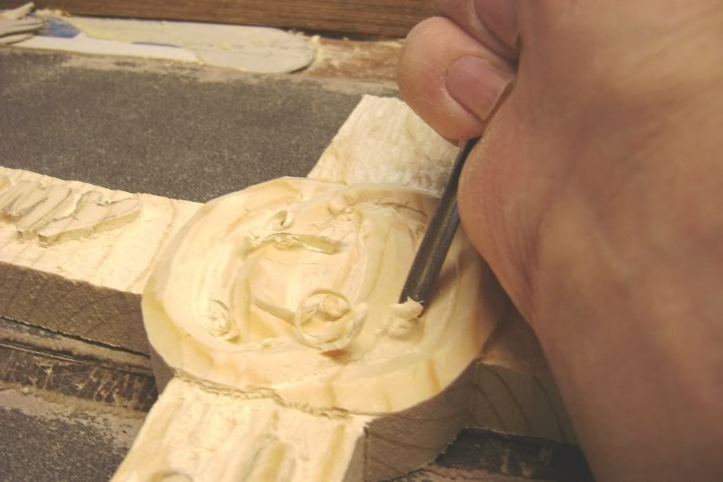

Here, I use a 1/2” V tool to clear the corners behind the rings on the back side.
The corners are clear

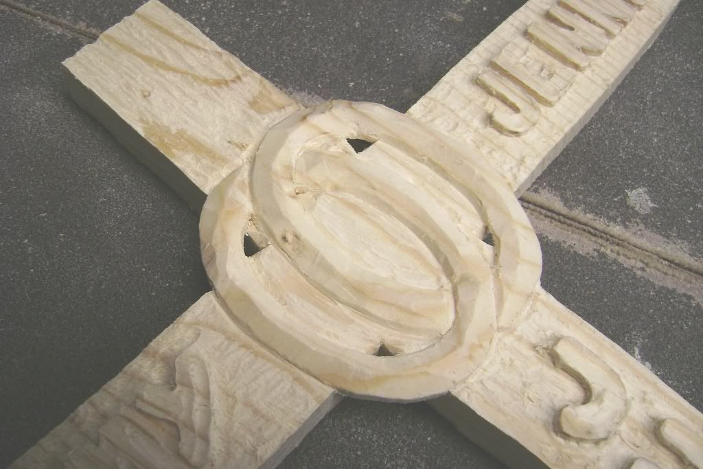

After the corners are cleared, it will leave a webbing in the corners of the rings… I hold the cross up to the light over head, and use my pen knife to remove the webbing, which will free the rings from their “locked in wood mode ”, and look free standing. Shown in this pic from the front side.
