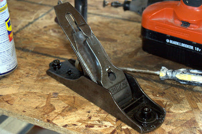

Well I am about halfway there that I can tell. I am restoring this to be a user, but I am not sure really how far I need to go. I soaked it for 2 days in a molasses water mixture after finding that molasses is a chelation agent like most of the other rustoff products…
As you can see, I dont have it “shined up”. But in think what you are seeing is what I keep seeing referred to as patina..but I really dont know.

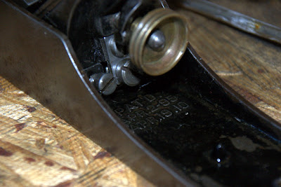

Here you can see the patent numbers, but also you can see that a good bit of the japanning is still intact. I currently have it coated in WD40 so that it wont rerust on me until I can figure out what I need to cover it with.

I dont think the blade is original. It has no stanley markings, and it feels pretty cheap. So Ill probably take it out and replace it with a hock blade and chip breaker…

You’re doing a nice job on the refurbishing and I’ve learned something new about molasses. How much elbow grease did you have to use? A 603 for $2.50 – I want to go shopping with you.

not a whole lot….make sure you heat either the water or the molasses so that they mix well. Otherwise its pretty sloppy and the molasses sits on the bottom. I let it soak for 2 days, then used my dremel with a wire brush attachment and just genly scrubbed at the parts. I also used a brass brush for the harder parts. I did take it out after the first 24 hours and scrubbed with the brass brush.
I used 12 oz of molasses to 1 gallon of water. There is supposed to be another kind of molasses that is really good for this called black line or black stripe or something like that.

Looks like it is coming along great. You can use clear schellac to protect the body of the plane. On an old bedrock I would not change the original finish to preserve it’s future value.

Yep, thats why I was hesitant about using the commercial de rusters, they seem to remove a lot of what the collectors are looking for….I was surprised after I got it all cleaned up just how much of the original black finish was still in tact….
Wayne do you think spray shellac or clear krylon would be ok?

I was applied some shellac with a brush. The idea is that it can be easily removed. I am not sure about the spray version. I would stay away from Krylon.
