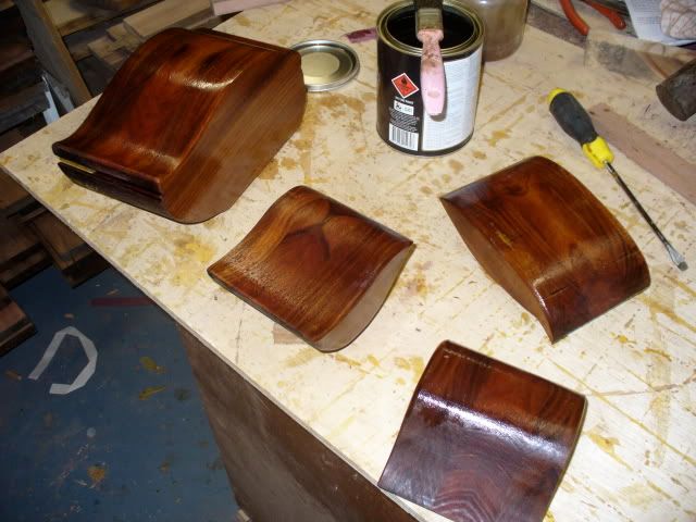

Stingray box and how I do it
Glue up half a dozen bits of board to make the block.,I used Tassie Blackwood and then bandsaw the back off at about 1/4 inch [ sorry no pics of this step]
Glue the template to the block and bandsaw the drawers
Glue the back ..back on..
Cut front and back from drawers and then cut recess from drawer carcasses and then after sanding the insides glue the back and front back on.,..
then cut the outside from the main body
Sand for a few hours or days and then finish with your choice of finish?

Bob and Len My bandsaw is a BAS 350 from Carba-tec here in OZ [ the Jet is a good machine],, 14" with 8" rise using a 1/4" blade.
Fin thanks for the encouragement and look forward to more blogs on how I do things,,not necessarily the right way but the way I do IT! I round over the front edges with a 3/8" roundover bit [only partial] and then handsand for a few hours i also use a linishing belt sander and a disc sander and finish off with a small ROS 120grit
