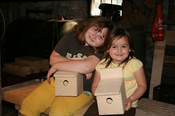

The two bird nesting boxes I made with my daughters

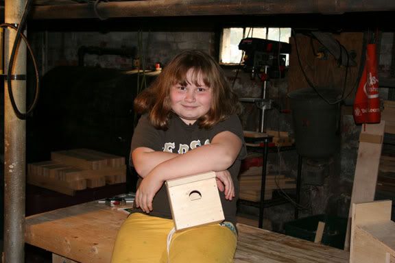

The girls both seemed really happy with their houses. Now it’s time to paint and put them in the wild!
Here’s Violet holding her nesting box.

Here’s a picture of Lila with her nesting box:
and the two girls together:
