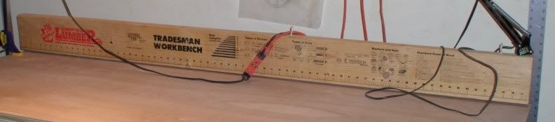

Chelle, a definite improvement over the old top. What type of hardwood edging are you planning to use? Can you post a close up of the back of the bench? Is that a ruler on it? When are you going to build those drawers to go underneath your bench? Add some peg board behind it and whalla, more storage.

Os – I haven’t decided what type of hardwood to use. It’ll probably depend on what I can dig up from my piles of wood. The back of the bench does indeed have a ruler on it. It’s also got guides for nails, screws, bolts, etc. I’ve never checked to see how accurate the ruler is.
