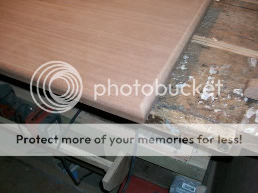

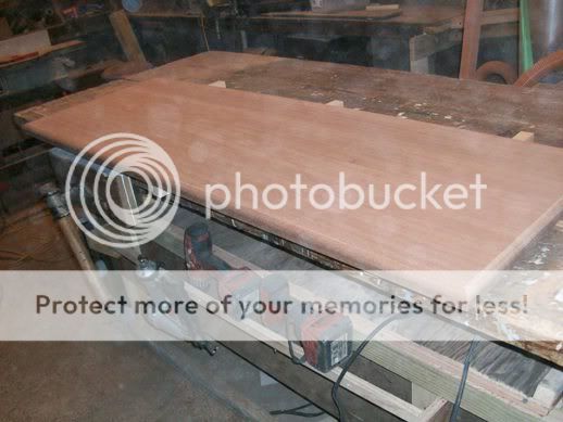

Just came in from working on the top. It's mahogany quarter sawn 5/4 thick. This is nice wood.
I had to join two pieces and I was concerned about the glue joint showing but it came out nice.
I would like to finish this with a low gloss finish almost matt finish. What do I use? How many coats and do I sand between coats?
