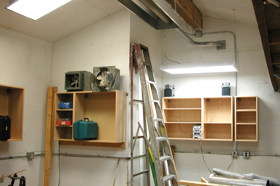

Yesterday the outside temperature peaked at -40°C/F and today it’s still down in the 25’s.
I have been keeping my overhead Calcana heater set at 50° F when not in the shop.
It has been right on the mark for the last 3 months.
Yesterday I went in and set the thermostat to 65° F and at – 40 outside it took about 10 minutes to reach a comfortable 65°. ( also a testament to the R22 Roxul wool insulation I used to encase the joint)
It also warms the metal on the table saw and the floor gets stocking foot warm in minutes.
These devices are everthing they claim and best of all they take no footprint with the vaulted ceiling design I chose.
From new shop

Bob Looks like a great deal. Is it propane, natural gas or electric? And what has been your experience in operating cost.

Kason, It’s a N/gas uit.
I haven’t checked my gas bill yet as this was the first cold snap this year. I put in a high efficeincy furnace in the house a few weeks ago too so it will be difficult to compare with last year.
The reports I have read suggest a 30 -40% reduction in natural gas usuage for the equivalent BTU output.
With the insulation etc. I am expecting to heat the cold months like this for about $35-$40 and less as it
warms. That’s what the president of Calcana told me I should expect right now.

Just noticed Roxul in the HD here in Brandon. Why did you choose this over the traditional pink stuff?
3041 posts in 917 days
posted 339 days ago
Hi Mark:
Roxul is denser and thus more noise proof. It is also fire rated which the pink is not.
So, I keep my neighbours happy from machine noise and my insurance down with the extra fire retardant protection.
It’s a lot easier to put in too with the more rigid batts.
