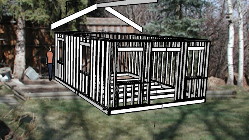

I wanted a sketch to show me the approximate positioning of this shed relatve to my backyard so that we didn’t have to sacrifice too much real estate for the foot print.
I am shooting for 18’ x 22’
I had a different location picked out closer to the back door but it was over ruled as it deprived someone of the view out the kitchen window. <g>
I can still walk (so after the beating…) I moved the thing here.
It seems to be floating in the picture and I haven’t found any button or combination of same that will sink it into the background picture better.

Hey Bob…not a bad start for someone who dosnt know Sketchup! If I could offer a few observations/suggestions..
It is always going to be tough to get a non photo-real rendered element to look correct in a photograph. No matter how you position it its always going to look like its floating, not to mention there are shadows in the photo and none on the building so that will add to the contradiction between elements. The bigger problems I see are that the structure looks like its floating off it’s foundation blocks. Also it looks like you have some things out of square/not perpendicular. If you look at the side wall either the wall itself isn’t a true rectangle, or the siding is applied croocked….same with the roof…if you look at the shingles they don’t run true to the edges of the structure. I would go back to your Sketchup drawing and bust out the measuring tape and start doing some checking. The one bad thing about SU is if your not careful it will allow you to build things out of skew. Make sure you have the units set to architectural and the tolerance set to 1/16”. Also set the snaps to the same 1/16”..it will make drawing accurately easier. Go back and make sure all your walls and roof structures are parallel and perpendicular and the right dimensions. When using the tape measure by default it will leave snap marks and guide lines when you use it…if you just want to measure with it hit the control key..that toggles it between leaving guides and just measuring..or what I do is I just use it with guides left on, click on where you want to start your measurement then when you get to the other point of measure don’t click…the tape should snap to the point by itself and the VCB (the little box in the lower right corner) will show the measurement. Then just hit ESC and then you can start another measurement and you wont leave a mark.
As far as photo match is concerned it is a great tool to help you line up your inserted image with the existing photo. I use it to get my sketchup image I am importing to match the perspective of the photo I am using as a background. Usually I do some lo res outputs to insert into the background image changing them slightly till I get the perspective correct. Then once it looks like it’s correct I render the structure with shadows turned on, then bring both images into photo shop and using layers and filters I combine the images to get the finished product. I am no expert on this..I just recently learned how to do this and I am still in trial and error mode. It is pretty tough to get it to look “real”
Details are the differance between a model looking real and a model looking “kindergaredenish” (your adjective!). One thing you might want to look at..you dont have windows..just holes in the walls..
If you want to post some specific questions or problems you are having with the software I would be happy to help you figure them out.

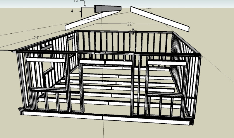

I’m driving myself crazy today with stick framing. I was hoping that they had and algorithm for offsetting a series of studs but I cant seem to see one . I have been deconstructing the preset frame members and rebuilding them. What a PIA. I could have done this job in half the time with Freehand.

Bob,
If you move a stud 16” with a tap of the CTRL key(makes a copy), and then type *30, it will create 30 studs 16 inches apart if that helps :) It’s actually detailed on the “Move tool” help page.

Tom, you just took 3 hours off my day today. Thanks.
I have to wonder why when you orient your model than everything from that point on comes in on a different plane from the oreintation.(components) It seems the data co ordnates should be kept by the program somewhere and refered to when an objest is brougt on to the project.
Who would need a window for instance lying flat on the ground? <g>

Bob – your issue with the window can be set in the component settings – I think it’s “always snap to vertical” or something like that. I’m a long time AutoCAD user, and SketchUp is pretty frustrating for me, too. I caught on really quick to a few basics, but I just can’t seem to get past those few skills. I look at some people’s SketchUp models and think “that would be easy enough to draw … in AutoCAD!”

By the time I build the standard components for a 12, 16, 20, 24 foot walls so I can skootch out a 22 footer my entire morniing is waisted.
I tried to place a 20 foot beam in position for a 4/12 roof today and I swear I chased this board completely thru the universe only to find that by the time I got it positioned it was 2×14 instead of 2×10”.
