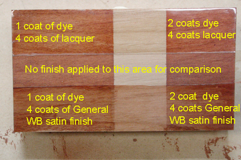

To put an end to this blog for the time being I wanted to share a photo with you all that shows haw the colour is affected after the finish has bee applied.
The center of the picture has blotch control and stain only.
The top part is blotch control and nitrocellulose lacquer.
The bottom is blotch control and General Finishes Poly Urethane satin.
From blotch control
