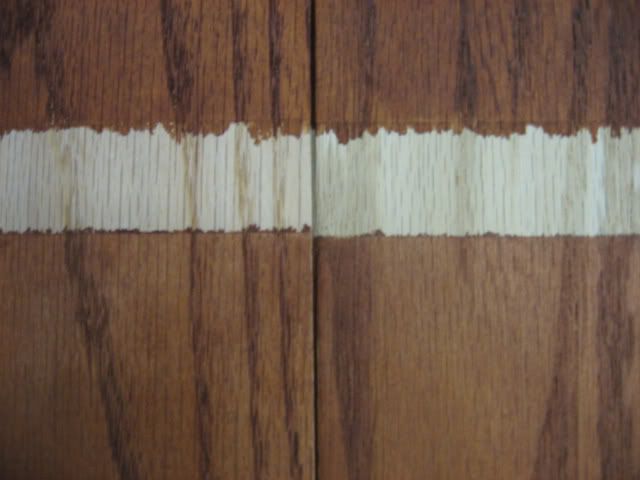

Here’s a side-by-side comparison with the blotch control product on the right and the general finishes on the left:
From blotch control
As you can see the results from the General Finishes are far different from what I got using the Blotch Control as the first coat then the stain.(left sample) if you notice the sample on the right the stain at the top of the test is at least a shade lighter than the stain on the bottom. I applied a second coat of stain on the bottom to be sure I could build up the color if needed. As you can see no streaking, no blotching.
Here’s a close-up showing how well the grain in this piece of Alder is reflected through the stain and is actually enriched compared with the results on the left.
From blotch control
The other thing that I noticed was that the stain laid on top of the blotch control and seemed to maintain its color value better than the stain on the left which had mixed with the wood itself and actually gone off its original cherry coloring. Where I applied it over the sanding sealer it became quite streaky and blotchy. Not what I was looking for at all.

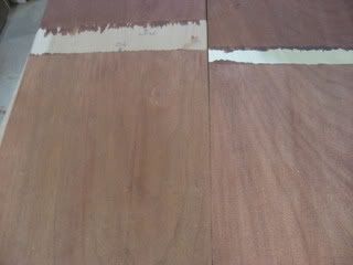

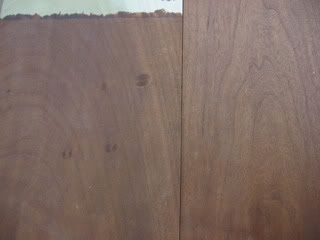

Bob, I have also been testing Charles blotch control product. I did my testing on a piece of cherry with sap wood and a piece of poplar that had a lot of green in it. The product worked exactly like Charles shows in his video. There was one thing that he did not show on the video that really sold me on the the product. Check out the picture below. This is the same finish oil and water base on both the cherry and poplar and when I laid them side by side it was difficult to tell which wood was the cherry and which is the poplar.
I also did a test with a piece of oak and a piece of oak plywood to see if I could get them to match.
Here is one last picture to show how well it handled sap wood.
The only thing I think Charles should have done was to name this product COLOR CONTROL since it does more than just taking care of blotching. I also agree with you that this product is easier (and cheaper) to use then the old way of mixing shellac and alcohol.

Mike , looks stunning on the cherry vs poplar example.
I’ve never been able to get this close without really ” tweaking” the stain process and or using tints in the finish coat which can be less than rewarding if you re matching something.
I found I could practically paint a picture on the wood once Charles product formed a base for the dye stain Like you, I can hardly wait to get after it and I usually dread finishing.
