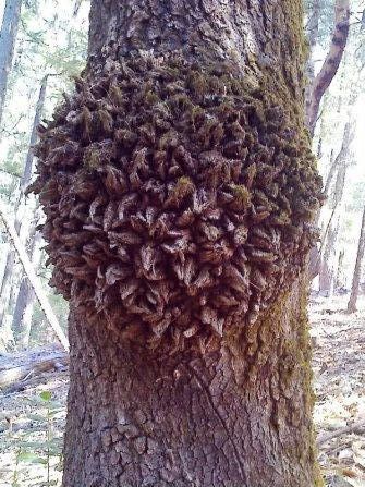

Yes! Oak burls turn great. I have found that most oak burls are realy bunyuns. I have rarely found turn “pin” oak burls. but the bunyuns are still beautiful wood. This is a pic of a black oak burl.
