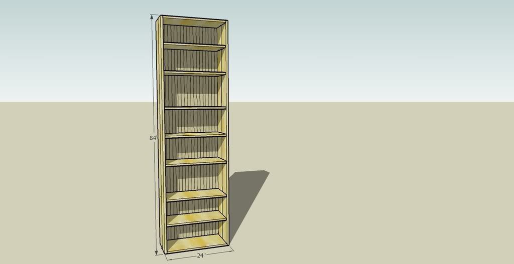

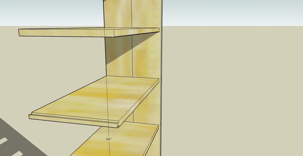

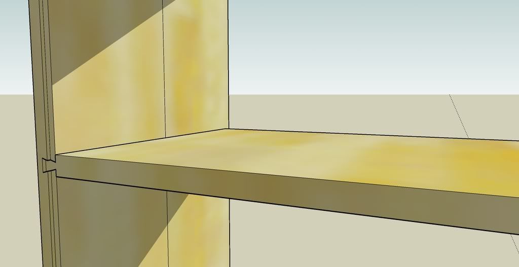

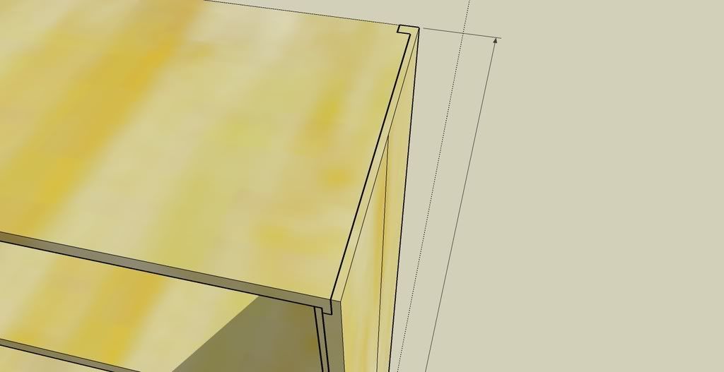

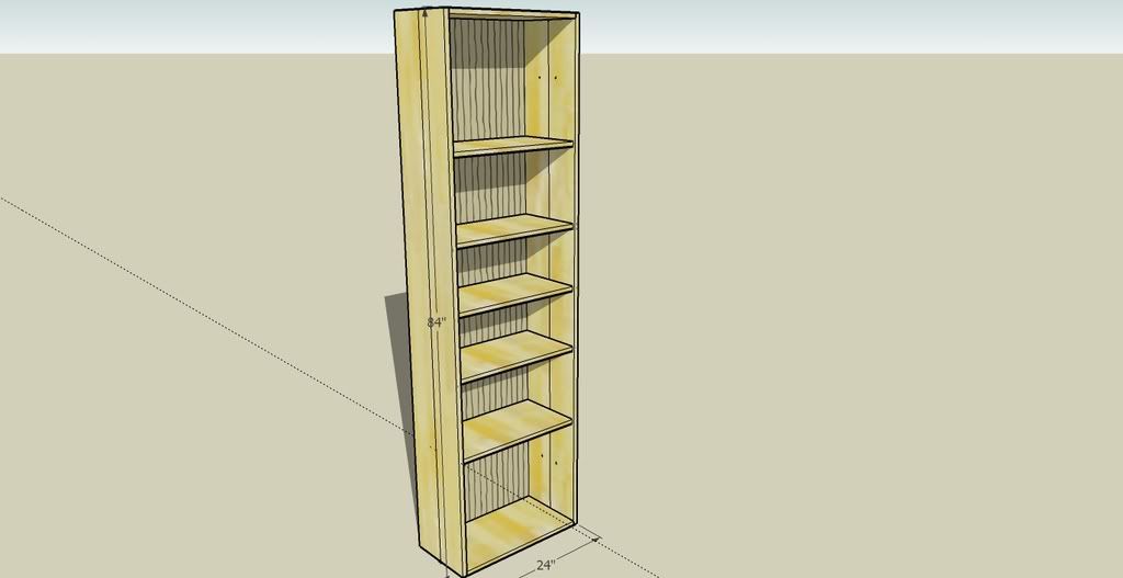

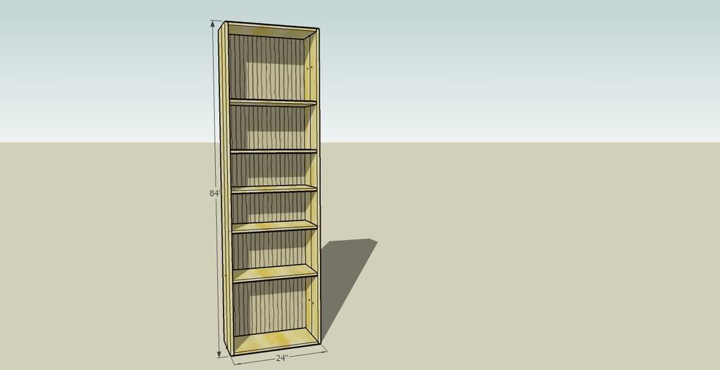

here are the pics I promissed
angle view
shelf joints
dovetail
carcass joints
view with shelves
view without
As you can see the top and bottom shelves are removeable (I plan to use shelf pins). This is a feature my wife wanted since he is young now and has taller board books and such but when he is 15 he may just want extra shelf space for regular paper backs. And before it is asked yes I plan to secure it to the wall.

This looks good to me. I like the sliding dovetails.

Great drawings Jimmy. Now comes the fun part.

Looks like a cool plan! The only thing I’d do is put that bottom horizontal piece (I initially typed “shelf”, which it is, kinda) up about 4” and put a strip across the front, that way if the floor and the bottom don’t have the same notion of “flat” you can adjust easier.
I also find that a little kick room to bang the broom around on the bottom of things helps.

I would change the back panel to at least 1/4 inch. 1/8 seems much too light to me. I use 1/2 inch back panels on my cabinets because I consider them an integral part of the construction. I then get cussed because the cabinets won’t “rack”. You should make your dove tails with one pass with a straight bit and then one or two passes with a dovetail bit. n
There is a very good adjustable jig for cutting dados with a hand held router. I use one and they really work. Be sure to set up test pieces to check your set ups. I hope this will ease things a bit. I agree with Dan about adding the kick board. You can do it, we will watch. LOL

Thanks all for the support. Thos, I planed to use a piece of hard board or ply to setup the dados and dovetails so the position wil match on both sides, starting at the top and cutting down to fit each level. I guess for the tapered dovetails I can just shim this “jig”. I had also planned to use a straight bit for the “hogging” of the waste on the dovetails. If I plan on a 14 degree 1/2” dovetaile big set to 3/8 inch height, what size straight should I use? I am sure I could figure it out but I am also sure you already know. I am working on the Kick board now in Sketchup. As far as MsDebbieP’s comment about it being a beginner project, I know it is not. My only two saving graces are the fact that it is pine so I can afford a few mistakes and allot of scrap to set things up, and the wonderful help and ideas I am sure I will get from my father and the great people here at LJ. Glad y’alll enjoyed the blog, I will try my best to ballance work and passion (as I am sure most have to do) and keep it up. One question, is the average toe kick 3 or 4 inches? I was thinking more like 3.

Well here is the added toe kick. Real basic but I like it. with toe kick

I think 3 would work fine if it’s flush with the front face.
