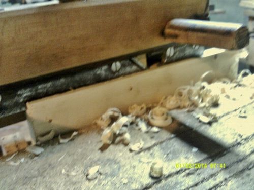

Got everything fixed, I think, so, why not a test drive, just to see how this plane will work?
Might be a bit fuzzy, but this is where one starts a plow type of plane.
Then, just take longer and longer strokes, working back as you go
and watch the curly shavings just fly out the side.
When you can take a full depth cut all the way from end to end, it should look like this. Until I get the finishing supplies in, this will just have to do
Getting close to the “finish ” line now…
