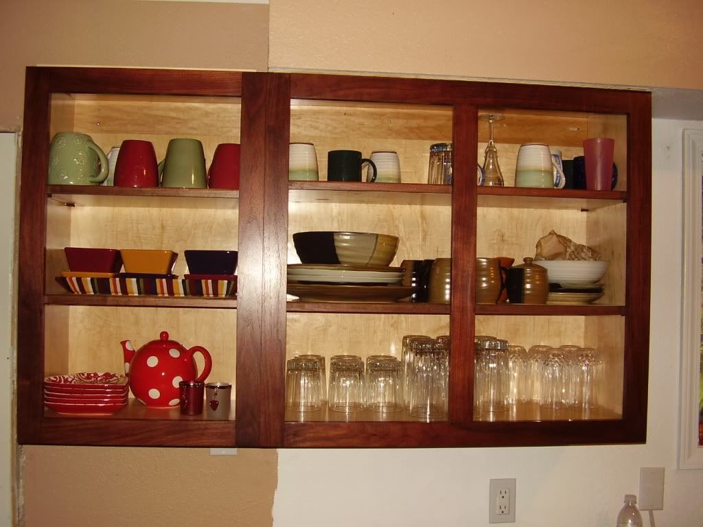

Working on new cabinets for my kitchen. Have many of the boxes done and all my uppers hung. No doors yet. Making from Walnut. Wife likes darker wood so I went that route. I was able to match our laminate wood floor very well. All are face frame construction, tongue and groove, with pocket holes in some areas. Using titebond III glue. Minwax polyshade in bombay mahogony. Two coats of that (wipe on) and then two spray on of poly clear. Letting off gas in the shed for two weeks prior to bringing into the house seems to be working well.
for the doors we had thought we wanted cathedral but are now looking at just a simple raised panel with an edge treatment. Still going over that in our minds right now. Will decide when return from Hawaii. May be some 80 degree weather will provide some inspiration.
Looking for some input on drawer slides. I am considering the Blum Tandem sel closers but would like to talk to someone who has installed them.

My uppers are in
Uppers

#7 posted 1398 days ago
Uppers without crown or doors
