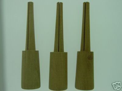

i’d seen other tutorials where guys were making individual jam-chucks and parting off rings from larger blocks etc. seemed like more work than necessary. this way works good and fast! done in 5 minutes for a simple ring.
here is a Similar thing to what i was talking about with the split-mandrel idea, i’d just make it out of wood i think.

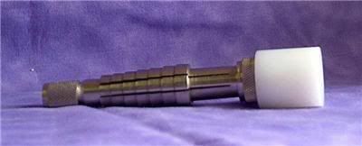

though buying a metal one i dont have to worry about carving into the wood,its likely just dull the gouge if anything i think. ah hell, it’s $12 total, i’m buying it :)
here is EXACTLY what i was talking about, only morse taper the bottom and size teh split-taper appropriately !

i receibved the metal ring-stretcher a few days ago, been playing with it..
it works nice for certain sizes, and no danger of breaking as i just push it in by hand.
the only way i found to mount it though so far was in a 3-jaw mini-chuck, not the best solution,theres some run-out visible. well i guess i’ll find a use for it for something.
