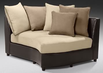

#4 posted 08-11-2011 06:45 PM
Here’s an image of one of the corners of the sectional.
On further investigation, the manufacturer’s name is Trademarked by the furniture store, so it looks like I’m SOL.

I want to point out that the picture you post has a REALLY complex curve, both in and out, It means bending the wood to frame (or using plywoods), and then a very thin layer of batting, and it looks like sewn leather. It also appears to have relatively minimalist (READ: unforgiving) lines to it, which means you have to be somewhat precise with your stitches lining up with the lines on the frame. And everything has to be sewn before you start stapling.

I have been sewing since I was about 7, and using a machine since I was 9. Thanks for the link on Upholstering, I’ll get some good use out of that. I’ve created a good mockup of the base in Sketch-up, now I just need to start making the modifications to that model to get the best design for me. The corner pictured above is usually placed in a group of three , but I only want to put 2 of them together, so I need to make some adjustments so the front of the sofa doesn’t vary too drastically between the two sections. I’ll post an image once the adjustments are complete.
I was planning on handling the curves on the front piecemeal since they are going to be covered anyway. In the image, they are covered in vinyl instead of leather. I’m not sure I could justify the expense of leather for my first BIG project, but I might change to leather the first time I recover it.
