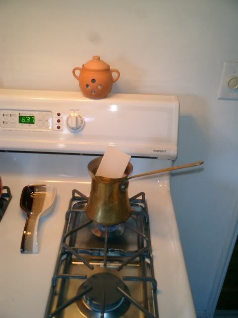

I just did this last night. It took me about 2.5 hours to cut the log, rough up about 4 bowl blanks, one box blank and wax up the remainder of the square stock (about 12 pieces). It actually took longer to melt the wax than it did anything.

I’m right there with you on the time it takes to melt the wax! I recently cut some tulip tree blanks and waxing them was what took the longest – though it sure was therapeutic! Heat the wax, take it outside, let the wood soak it up, go inside, heat more wax, go back out, let the wood soak it up…

Every Christmas it is fun to make some gifts to give out to special someone’s, on your list. My family loves the stuff i make and fight over it. We have a drawing. But I make a few extra things for my favorites. Is the wax cheaper than anchorseal? jockmike
