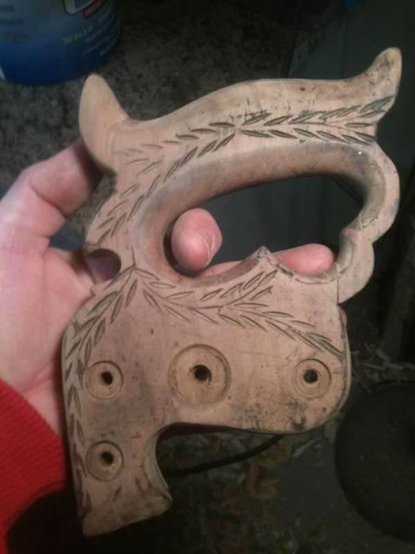

The tote drew me to the saw in the first place, which was at an outdoor flea mkt area in a neighboring town. I went back a week after seeing it initially and paid the $1 asking price. Here are the as-purchased pics:
Took it apart, and the blade went into a makeshift Evaporust tank for a day or two.
Now for the tote. It’s fancy in it’s carving, and obviously well worn. Someone loved the saw, and it’s clearly an everyday user from someone’s past. Problem is a missing upper horn. I used a 1” chisel to flatten the chipped surface, and even after an initial effort there’s evidence the horn’s base was sanded over OR worn smooth by hand over the years… So the piece I add will be shaped with rasp, saw and file to something, but first and foremost needs complete contact at the glue surfaces.
The saw on the left is the donor, and a cut of it’s horn was made:
More chisel work, some sanding, paring, etc. and I have an oversized donor piece glued in place to set until I try shaping it.
More to come!

#1 posted 02-13-2012 04:15 AM
Looks quite encouraging. Can you tell grain direction and the relationship between donor and recipient?
Two days in ER that is quite a while. I am interested to see how the pitting turns out.

#2 posted 02-13-2012 04:19 AM
Truth? Don’t know about the grain at all. It was placement of the donor that was number one at this point… If it doesn’t hold as I’m working it, I’ll sand the original and what’s left of the donor and start iteration number two, with grain as #1… Brit told me align the grain; I’m hoping I get lucky. :-)

#3 posted 02-13-2012 04:20 AM
Looking good Smitty. Keep us tuned in. Do you or would you want to put a dowel in your horn repair?
Smitty_Cabinetshop
15366 posts in 2640 days
#4 posted 02-13-2012 04:38 AM
Thanks Dave. It’s pretty ugly right now, but I think I have enough material in the added piece to (obviously) removed the battered edge and leave a nice, clean demarc. RE: the dowel, there’s not one there in what was glued tonight. I’m putting my stock in a solid joint, one that’s strong enough to withstand the shaping I’ll be doing. If it fails, I’ll look at other options.

#5 posted 02-13-2012 05:19 AM
Great idea, Smitty, stealing a horn from another handle. Also, the other handle should be a good source of other small scraps for future restores. Looking forward to seeing how this thing turns out!

#6 posted 02-13-2012 06:13 AM
Okay, couldn’t stand it. After letting the transplanted horn set for about 3 1/2 hours, I went out to see what it looked like and to start filing. Very pedestrian tools: a small rasp, some bandsaw work on the outside edge, a 3M 180 grit foam sanding block, and some 100 grit sandpaper wrapped around a dowel rod. Here’s where it is as of tonight.
So far, so good! It’s an art more than a science, figuring out where soft curves turn into hard edges. On a time-worn handle like this one, though, the pressure is pretty much off… :-)
-- Don't anthropomorphize your handplanes. They hate it when you do that. -- OldTools Archive --

#7 posted 02-13-2012 11:56 AM
That looks really good

#10 posted 02-13-2012 06:14 PM
Wondering about getting the handle ready for finish. Is fine sandpaper pretty much the 90% solution? Don’t want to erode the carvings anymore than I have to, but stripper seems harsh.

#11 posted 02-13-2012 08:05 PM
On my D-8 I used a cabinet scraper to remove the finish, sanded to a 320, then wet sanded varnish with 400 grit w/d paper.
Over the carving a sanding block would be helpful.
-- "It's only wood. Use it." - Smitty || Instagram - out_of_focus1.618
Smitty_Cabinetshop
#12 posted 02-13-2012 08:07 PM
I like that. Many nooks and crannies in this tote, so I thinking my mini-files will get a bit of a work out, too. Thanks.

#14 posted 02-14-2012 02:20 AM
Thanks, Dallas!
Here’s an update, after just a bit of sanding and shaping again this evening. I’m liking the graft…
The whole thing with the light sanding everywhere that’s done so far. How much more sanding do I need to do?? Anyone??

#15 posted 02-14-2012 03:34 AM
Looks good to me Smitty. What about that hair crack near the bolt hole?
