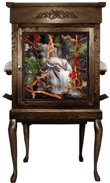

Here is one I found on the Internet that surprisingly has the same Q.A. look. I don’t much like the top, but this should give you can idea of the general look. A lot of the others I have seen have cabinet bottoms like an aquarium and that is just too heavy looking. I am looking for something more elegant.
aviary example
