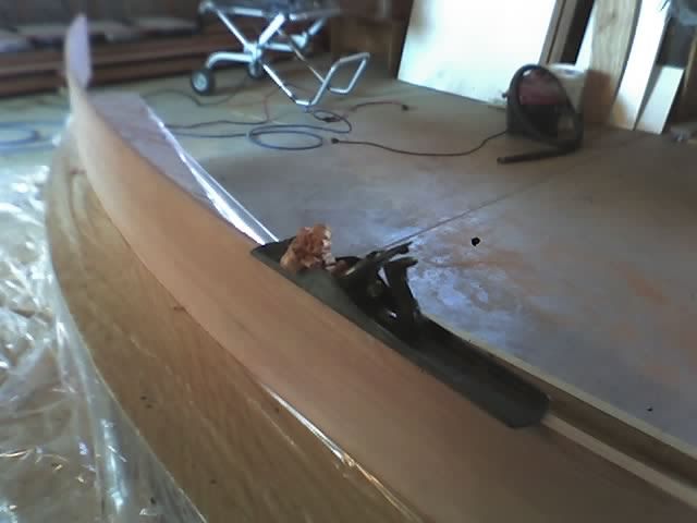

Here’s a piece with a 16’ + chord length based on a 13’ and change radius. It was for window trim . . .Photobucket
There’s no shame in grabbing a scrap or 2x material with a jointed 90 on it to hold beneath the sole to use for a “fence” as you’re jointing. If possible clamp two or more pieces together to have more bearing surface for the sole of the plane. If jointing pieces of the top orient the “show” faces all one direction, say to the left. This way even if you don’t joint a perfect 90 on the edge when you put the show faces together they will fit because the imperfection will offset, i.e. the long edge on the left piece will mate the short edge on the right.

GC is absolutely right about no shame in ganging the boards together and using another 2”x as a backer to keep square and consistant. Make sure the backer is a comfortable height either low or high… helps prevent the knuckle peel… Hint-use 1/8th’s spacer a little lower between the backer and the stock you’re planing to make up for the side of the throat where the blade doesn’t cut.
If you gang your stock you can make thinner cuts / shaves but still finish quicker with better result.
