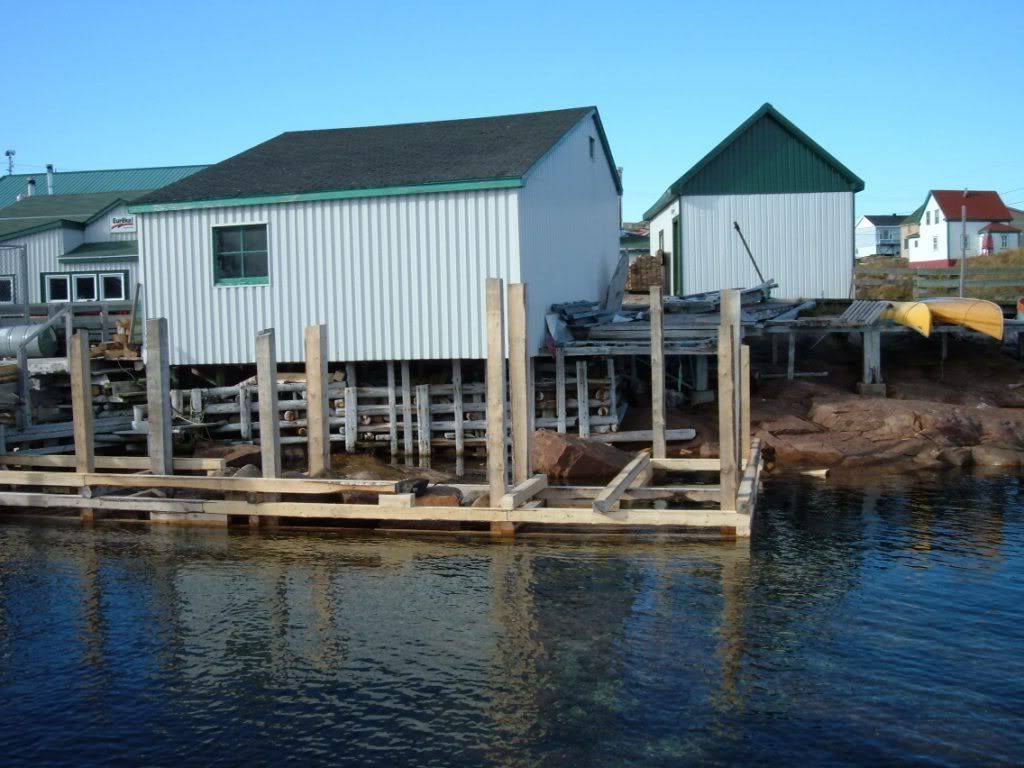

Well starting to “lay” the foundation for the new shop.Most people pour a slab, dig a basement, or clean out the garage. I have to do things alittle differently.
First I wait for low tide. Then I start building cribwork. Fasten this to the rock and then when the tide rises and I can’t work the wood I bring rocks to fill the cribs. My shop will have water under it during high tide
Outside side of Building will sit on inside row of 8×8. Other white shed is to be taken down this coming spring

Thanks for the extra photos. They tell a lot about your home.

So where does the ice get to in winter? It looks like some good size rocks are available all over the shore line.

ok here goes. If you look at the second pic the bridge with the rail on it runs out to a crib that I tie my boat to . I can tie up there in all but the lowest tides. The ice freezes about a foot under that bridge. During fall storms this bridge can cover at the very highest tides. When I start rocking the cribs I will post more pics.
