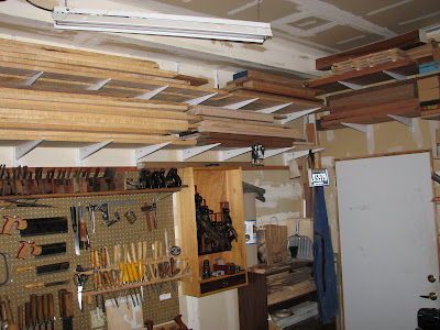

When I took on the Bowling Lane Workbench project, I knew I’d have to reorganize the work space a tad bit (ok, more than just that). Especially since I also got the planer which takes considerable space, I knew things would have to be moved around to give me room to walk/stand, and work comfortably and safely.
the new workbench now resides where my medium/longer (anything that wouldn’t fit in the short lumber storage) lumber used to stand on edge. so a new place for those had to be setup.
I used rubbermaid modular storage rails and bars. we had used those in the past for our desk stations, and since we moved back to Boston it was just sitting unused in the basement, so I figured I’d put this to use.
I installed the bars on the beams uaing 3 1/2” drywall screws (for added holding power into the studs), and use 24” supports to hold the lumber. it holds quite well so far, and I’m going to limit how much I put on it as I’m not sure if this might be an overload on it or now (it looks ok though, and it used to hold quite a bit of weight before). I also placed the brackets so that the planer can fit underneath, and maybe in the future, I’ll also fit the (to be built) router table under there:
medium lumber stoarge shelvings
This really cleared some major real estate space in the garage, and I’m able to move freely and work on each station safely and without scraping my shins now – which is really nice :).

That looks like you will get some good space savings and excellent air circulation to boot. I realize that if you stack it too tight, it will negate the airflow that you have, but do you have any idea what this system could realistically hold?
View PurpLev's profile (online now)
PurpLev
2750 posts in 543 days
posted 99 days ago
thats a good point HokieMojo. as I was tidying up, I didn’t stop to think about that. I’ll space them out a little bit. as far as capacity -rubbermaid claims those shelves are supposed to support ~350lbs between 3 of those brackets… which is impressive. I doubt I’ll get anywhere near that weight with what I’ve got which is a good thing.

PurpLev,
I’ve been using the same lumber storage system you just installed for two years now. They can hold a lot of lumber, I feel that I’ve pushed mine a bit more then I should have but it seems to be holding strong. I installed a track/brackets 16” apart/per stud. In the picture there is well over 300+ bd/ft of hard maple and other species.
To strengthen mine I used 3 1/2” drywall screws, and I added two more to each vertical bracket so there are 4 screws into each stud. As you can see in the photo, the system is very cheap to use and I’ve pretty much filled up every single square foot of wall space to store wood.
I live in colorado which is basically a kiln when it comes to drying lumber.. I don’t worry about air circulation at all, the tighter I can stack it.. the more wood I can horde. :)

cool, Scott – I used 3 1/2” drywall screws into the studs as well. the last thing I wanted is to have the entire thing come off because of weak screw coming off.
glad to see it’s holding off so well. comparing numbers, this is by far more capable than the triton rack, and more versatile (longer brackets). so I’m pleased with this.

A word of Caution , my friends…Drywall screws have NO shear strength and the heads often pop off of them when you least expect it.

it’s an interesting find Len, however it seems like this has more to do with a high impact, and not quite shear force alone. as it may – the bars are fastened with 6 screws each, so the force is spread across them all.
I’m not saying drywall screws are the strongest – based on that video, it seems they are not -but I have been using the same setup for years and it seems to hold up very well.
still – a good point, and something to consider in the future- so Thanks for pointing that out.

Hello Sharon , over the years I have had numerous drywall screws pop their heads right off when used for construction purposes.
The video is an exaggeration of shear forces for demonstration purposes.
I used some 3.5” screws in a garage shelving /storage area only to end up with the shelves and their contents on the floor after a period of time. Nothing left on the wall except the sheared ends of the screw shafts and that was with using a quality name brand screw.The metal used for drywall screws is quite brittle when compared to others. You have to figure that the screw heads are already torqued against the brackets and each additional pound of weight added just increases the stress (aka shear forces)on them ….The tapered (bugle head) screws are meant to sink into the soft drywall easily , and when they come into contact with the metal brackets , they are stopped dead in their tracks causing stress on the brittle screw shafts.
I’d just hate to hear that the screw heads had given up and your shelves and their loads had fallen and had hurt you in any way . I’ve also worked in the building materials business for the past twenty odd years and have heard all kinds of horror stories from people that used the wrong fasteners on the job. My only concern was for your safety , my friend : )

Thanke Len – as I said, I never had any bad experience with those – but if you personally had, then I guess I’m going to reconsider, and swapping the screws with something more capable. Thanks for the insight. definitely don’t want to go and find all that lumber/etc ‘reorganized’ around the shop.
