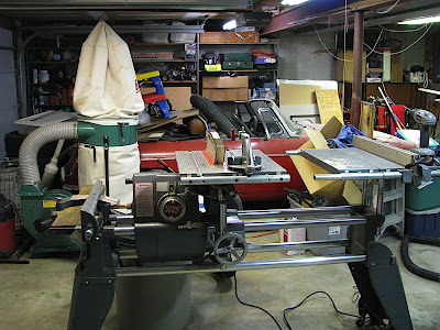

At first I thought it was just my imagination. I took some deep breaths this morning and felt very constricted and tight in my chest. I was just coming down the hall when I heard my wife Peggy also blowing her nose and sounding congested. We talked and neither one of us was experiencing any symptoms like that until last night’s cutting on the garbage can holder.
We decided that the bag filter system was definitely next on the “must-do” items to help our health. Today I called Wynn Environmental and placed an order for a 9E300BL that I will be retrofitting on to my Grizzly 1 1/2 horse dust collector. I plan on taking a lot of photos of the conversion and any pitfalls I run into. I’m also thinking about that machine placement also. I might have to give-up my current chop-saw location (hot sparks) but I think moving and having one collector pipe might not be a bad thing.

look forward to seeing the pics look get yourself checked oput if you have tightness in your chest.Alistair

The lower cost dust collector bags don’t do much for the fine dust. I replaced the bags on my Shop Fox DC with some shaker felt bags from Penn State Industries. This difference it makes is unbelievable.

do you know how many microns the grizly started with? I think I’ve heard 25 microns. I think 1 micron is reaonable for an amateur that plans to work regularly, but I think the filters are even better than that.

Some types of wood dust are very toxic. Our lungs have about four acres of surface area, thus anything toxic that we breath in goes into our blood stream very fast.
Get a 1 micron bag. I just put the 42” 1 micron bag on top of my DC3300.

It’s not just the cutting—the bags on the dust collector are very porous and I suspect that the amount of tme I had it on (45+ minutes) made the air very laden with not only what I had cut but the past ?? years worth of dust still lurking in that bag. The workshop that the dust collector came out of was coated EVERYWHERE in dust very thickly. Now if anyone wants to argue the virtues of a dust collector as mainly a big fine dust pump—go right ahead. I’ve paid attention to a lot of photos and setups on dust collection and the common thing I see in photos is no chips, but very fine dust particles everywhere. I know also real symptoms and when I can blow my nose and get goobery icky looking stuff after just blowing out dust from a piece of machinery—that’s proof enough for me.

I think that in a lot of ways, no dust collection is better than the bag-style collectors. If you have no collection, the dust and chips are kicked into the air by the tool, and then fall. With a bag-style collector, the fines are continually blown into the air, creating a constant dust cloud for you to breathe.

I agree to a certain degree on the bag-style collectors also—that’s why it’s worth it to me to change to a cannister style with finer filtering. I’m very anxious to see how things improve with it especially when it comes to sanding. It was interesting looking at the one page and seeing how much particulates are put in the air when the blade is burning wood, another good reason to make sure your tools are in tip-top shape and alignment.

I have to disagree to a certain degree with EEngineer on this one. As always – when we deal with generalizing anything, we cannot use individual cases as proof that the general concept is false. generalizing deals with statistics, and accumulation of a vast number of cases that all paint a ‘general’ picture.
some people are more sensitive then others, and in this case I do agree with EEngineer – many of us (heck, maybe even me) are also phychololgically sensitive to things that our body is physically NOT sensitive to.
With that said, and with what we know today to be hazardous, I’d rather be cautious, and use preventative measures than to say “I wish I did” 20 years from now.
As you can see in my blog – I did replace my crappy 30 micron dust bags with a 0.3micron filter from Wynn Env. I notice a night-and-day difference! Thank you Wynn Env. :) shame on you everyone else that even sell 30 micron bags to the mass market… It seems counter efficient.
After taking the original 30 micron bag off, I dusted it off, vacuumed it, and air blew it – it was amazing how much dust was coming out of it (took me 30 min to change it’s color from beige/cream – back to white)
