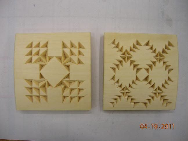

Ok, those are awesome, so, now,
here are 2 of the “Rookie” chip carved squares….. lol complete with “cupping” hahaha
I hope they’ll straighten out.
I wish I coulda done a few more, but, I’ve had too many irons in the fire. I know, it’s an excuse.
This was a great class. I hope to include a bit o chip carving/s in some future projects.
Thnx Marty for your expertise, and all Lumberjocks involved.
Good luck with the quilt auction.
I’ll get these in the mail soon.

Nice carving, Roger!
Did you finish the back of each square to help them stay flat?
If not, you can put a moist towel on the back to add some moisture.
Then let them sit and flatten out.
When dry and flat, finish the back.

Thnx Marty.
After realizing what was going on, I put the seal coat on the backs. I’m hoping they will straighten out.
Like I said…....... me be “Rookie” lol
I’ll spray em tomorrow with the Satin Clear you recommended.
I guess I shoulda followed instructions a bit better. I’m guilty of NOT reading the whole instructions on appying the finish. :)
I didn’t seal the back at 1st like I should have, cuz I figured the glue you were going to use wouldn’t stick.
I’ll see what they look like tomorrow
