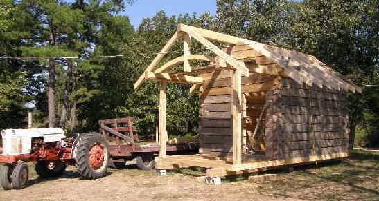

I am beginning to cut roof rafters from 4"x6"x10' beams. I'll need a couple dozen of them.
Recently we set the 25 ft. ridge beam and cut the gable end log to fit the roof pitch. Next we set the arch beam and king post. The first of 26 roof rafters is in place. Now a bunch more await.
Rafters are going up. They are 4"x6"x10' beams and heavy, heavy!

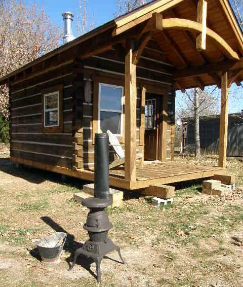

This is a little coal/wood stove that I got from an auction in Larned, Kansas. It's the perfect size for this little cabin. Although this picture does not show it, there is a fire burning in it. I was curing the coat of Williams Stove Black outside so that fumes and oder would not be inside. The old stove with its newly blacked exterior works perfectly.

I've been working on the inside of the cabin because it is very cold outside. The little coal stove keeps things at a comfortable temperature. Next I will be making the functional outside window shutters.
