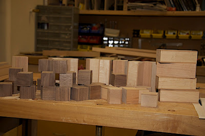

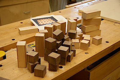

Here are the blocks cut into small pieces.

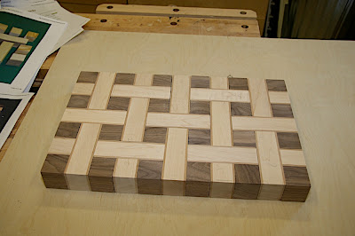

Rough layout before glue up

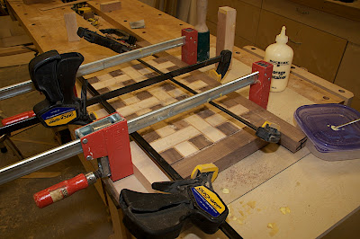

Glue up process – don’t over tighten the clamps – you want the final piece to be as flat as possible.

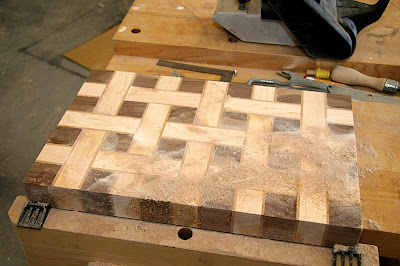

Here’s the sanding process. I used a hand belt sander to do sanding (go on an angle and make sure not to push too hard)
From Cutting Board Pictures

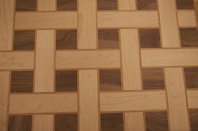

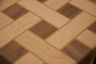

See the little gaps – that is because the cut (table saw) was off a bit but I was able to fill them so you don’t see the gaps in the final product. To prevent this, make sure you check your saw to ensure it’s square to the table top.

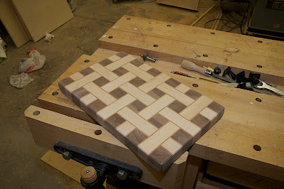

After doing the rough sanding with a hand belt sander and palm sander, I went to my woodworking supplier (Woodsource in Phoenix) to have them run the entire piece through a large belt sander. This make the entire piece completely flat. Keeping the cutting board flat is important when you consider it will be sitting on a honed granite counter top.

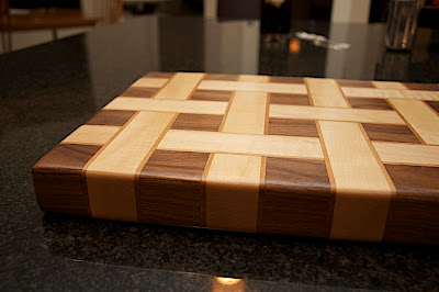

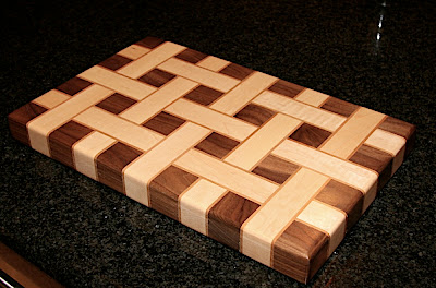

Here is the final product which I also included in the completed project section.
When I showed up with this in the kitchen, my wife refused to cut on it at first, but I broke it in the other night and it worked great and still looks beautiful. I made the piece pretty thick so I can re-sand and finish the piece when the cut marks show up too much. I figure that wont be for years though.
